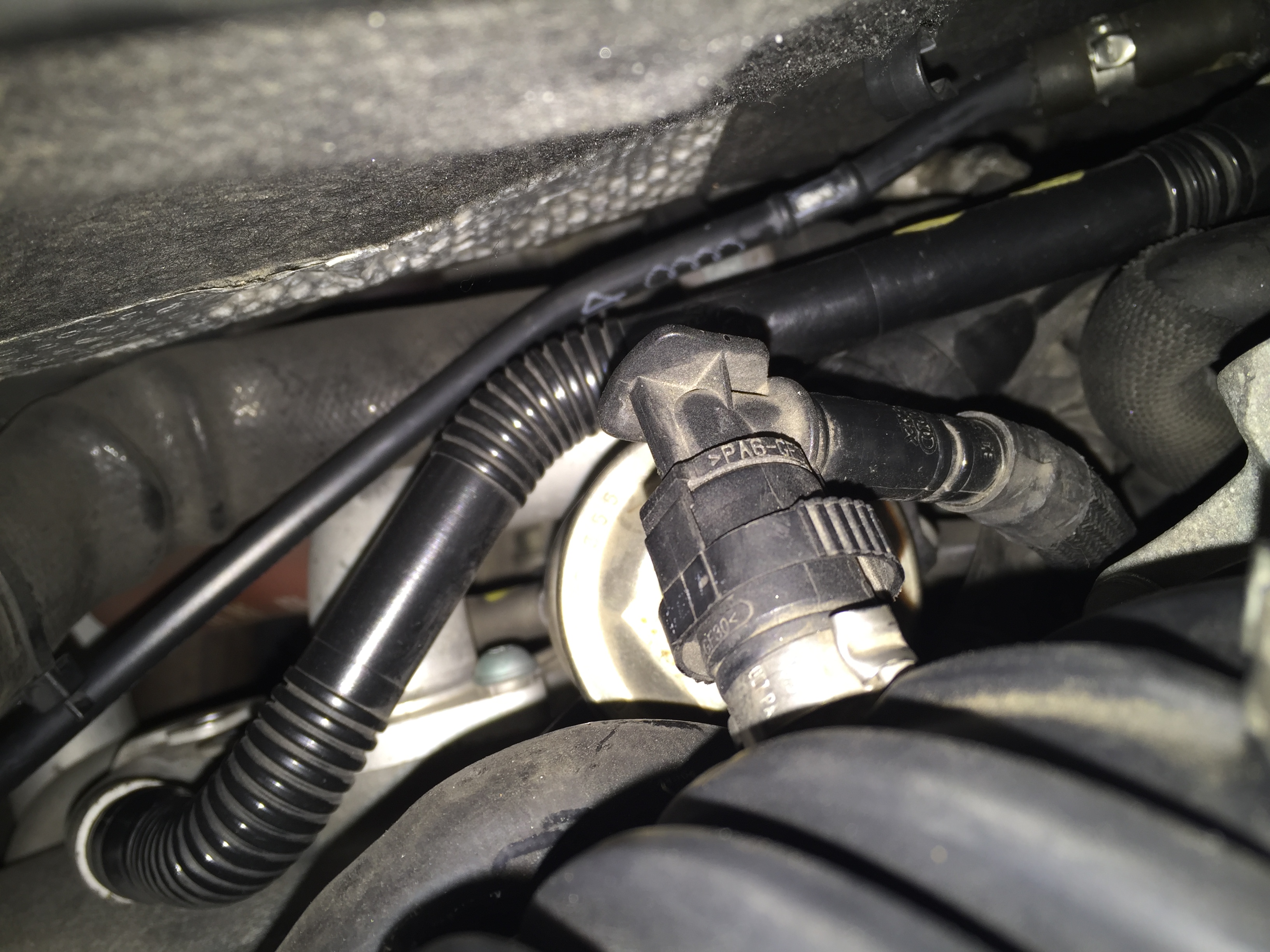

RichieRS
Posts: 645
Joined: Mon Dec 29, 2014 9:55 pm
Location: Cheshire
Re: Breather system
Post by RichieRS » Fri Apr 01, 2016 8:43 pm
Are these the 2 you speak of?
Lukes3
Posts: 657
Re: Breather system
Post by Lukes3 » Fri Apr 01, 2016 8:51 pm
There the ones i was thinking but thats the inlet pipe?

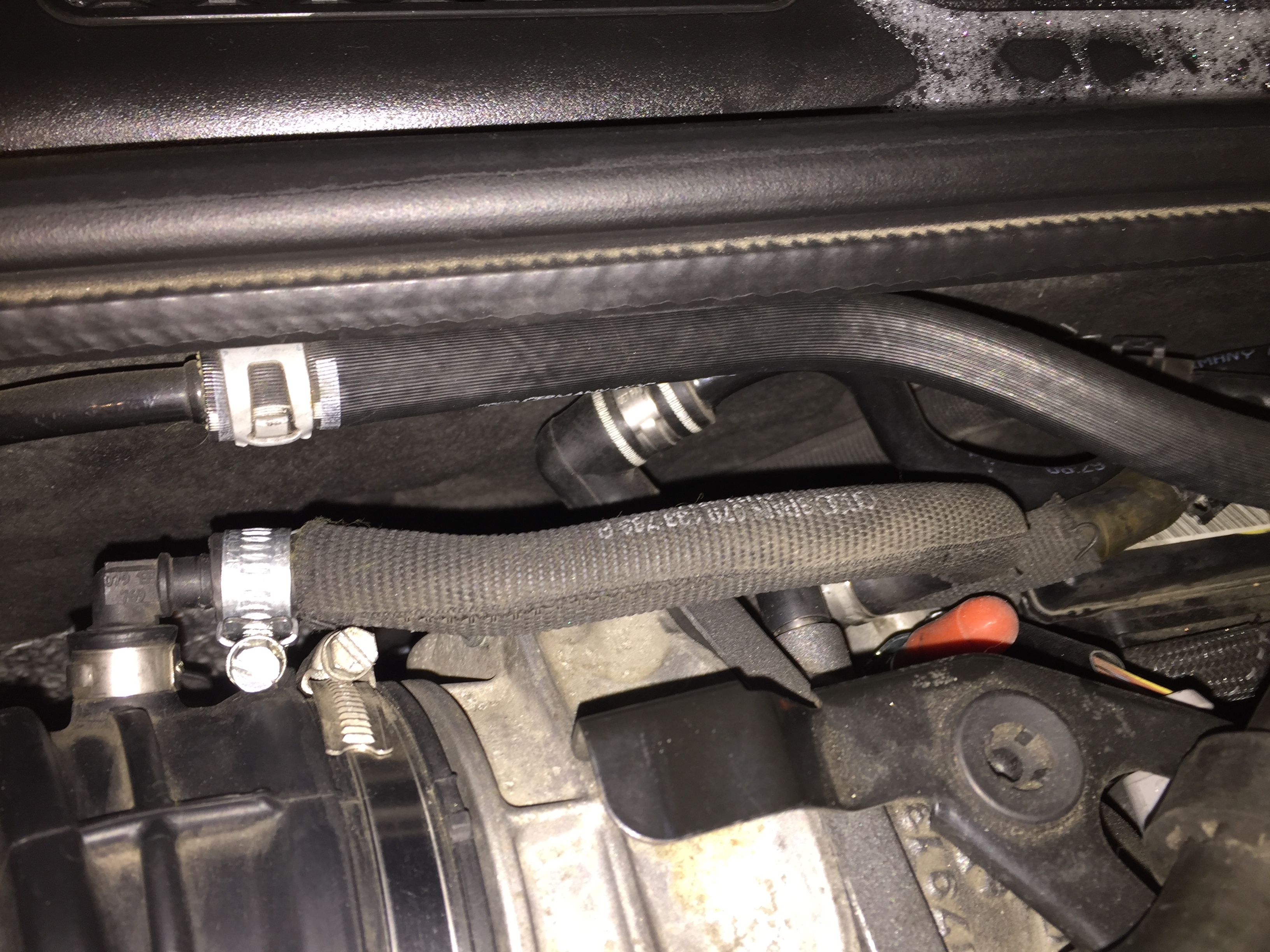

bond1407
Posts: 5
Joined: Wed Dec 02, 2015 12:49 pm
Re: Breather system
Post by bond1407 » Sat Apr 02, 2016 10:19 am
I got it slightly wrong the outlets are on the inlet manifold not the throttle body, you can see the bottom one with nothing attached and the side one with the yellow round the pipe, ive done some digging and I think this pipe goes to the bottom one and the side one should be blanked off which would make more sense as to why I have nothing for this outlet
Lukes3
Posts: 657
Re: Breather system
Post by Lukes3 » Sat Apr 02, 2016 10:29 am
Yes yellow has a bung on it An the bottom one goes under the manifold.

koolade9
Posts: 5
Joined: Wed Mar 10, 2010 12:10 am
Re: Breather system
Post by koolade9 » Wed Apr 06, 2016 5:55 pm
Bottom port connects to the purge valve. It looks like you've got that currently connected to the rear port on the IM, so swap that line. The rear-most port should be capped.
