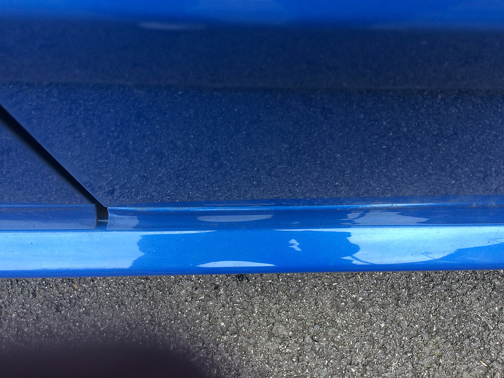

Noticed the exterior strip of trim at the very bottom of driver and front passenger door is bulging ever so slightly at one end. I removed the trim to have a look, just seem that the plastic fascia has bulged away from the backing is filled with all kinds of dirt, not sure what's caused it. The fascia and the back are glued together it seems so not sure how to split them without causing damage.
Been quoted £130 for each strip+fitting so it's gonna be expensive for a minor issue. Is there an DIY/cheaper solution?

Yep happens all the time on them especially if people are jet washing the car and concentrate too long on that area. It's only held on by a few screws on the inside of the door so worth taking off and having a good look at it. You can rebond it sometimes otherwise it's new parts which often require spraying.

My driver's door side blade did the same thing. The body Shop said they are prone to it. Apparently they have a metal strip on the back but the fastenings are made from a different metal (where have we heard that before with Audi :audibash: ) causing them to corrode and bulge.
I think it was about £100 for a new blade and the same for painting and fitting. Looks a lot better now though.

Right, done this now on both front doors.
Before, not massively noticeable but once you see it.....and it will only get worse as water continues to get in. You can feel the difference, the side near the door pillar is at least 5mm proud whereas the hinge side of the trim is flush with the door:
