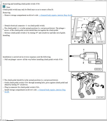

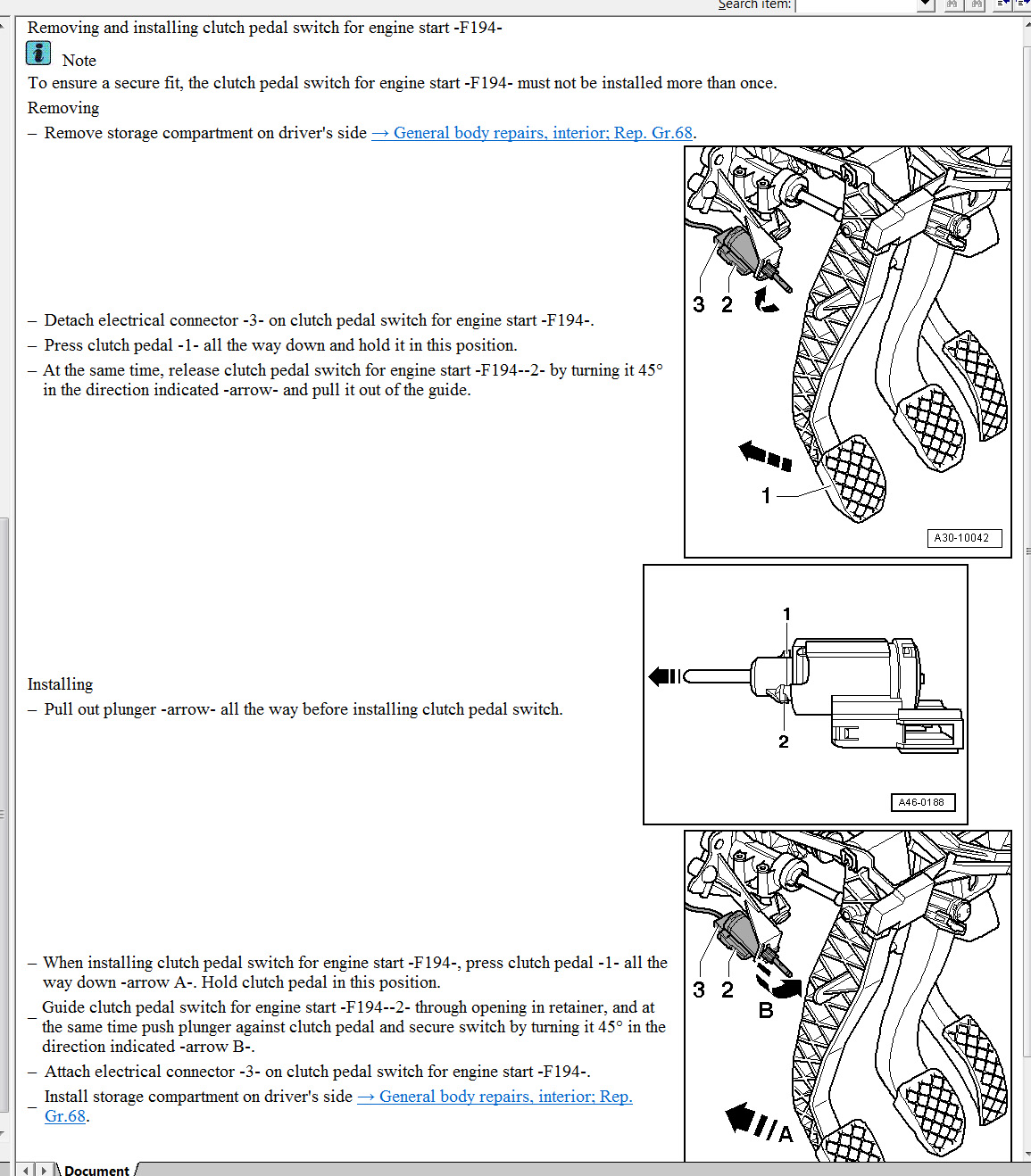

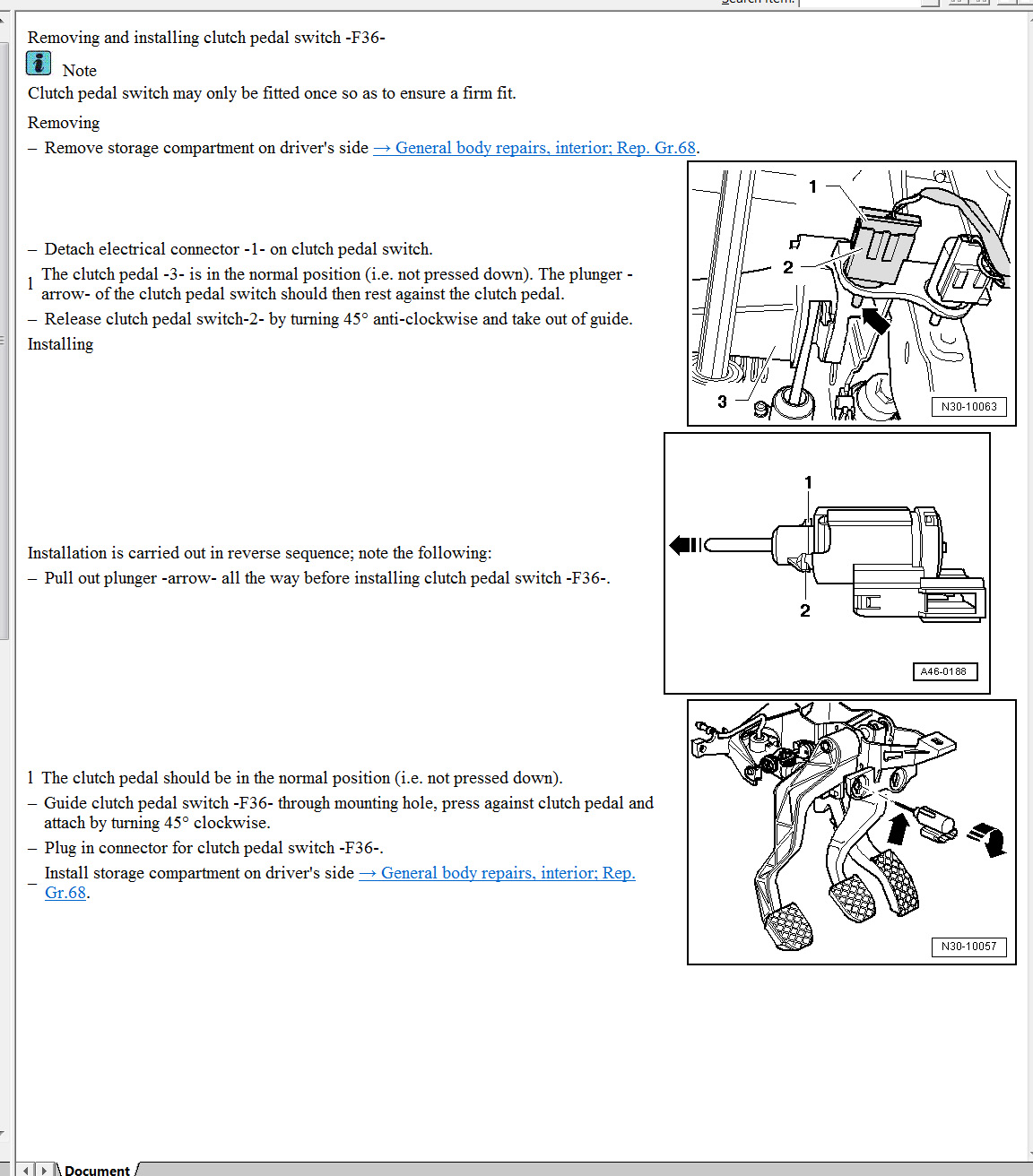

Never had to do either of these switches myself, but here is the info ELSA has on the process. If that's any help to you both?
click to enlarge
click to enlarge

Youre some kind of superhero Sam...
I bought the Bentley manuals on CD a while back.... but they only work on Win XP.... and i dont do XP
I think its safe to say that the procedure for switch installing remains the same despite superceded types etc
Thanks again for your help!

Sam, you da man! I was being very careful to not press the plunger in until it had been installed and twisted as per previous warnings I'd read, but that was the key bit I was missing, press the plunger before twisting!
Took me about 10 seconds to install it right. Car starts now without holding the button down and no EPC error light!
