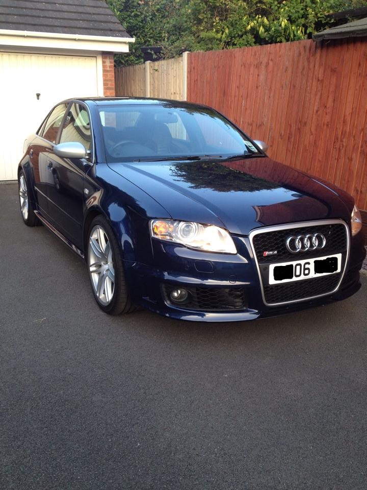

I have owned my 06 RS4 B7 Saloon for nearly a year now, and it has been a bit of a pain from day one to be honest. The car had 40k when i bought it and now it has just shy of 50k. It's driven properly and always been extremely well respected!
I've had a spark plug crack and coil pack break on me causing a misfire.
Both front seats lumbar support and inflatable bolsters packed up which also needed replacing.
The oil cooler was leaking too, which has also been replaced along with all pipes etc.
A faulty solenoid valve threw the EML light on, which has also been replaced.
Both ballasts for the headlights also packed up which i have had replaced, and while the bumper was off i thought i may aswell replace bulbs too.
The door locks have also been replaced, i had to press unlock on the key fob about 15 times for one door to finally unlock!
I have also had problems with the inlet manifold. Audi said they had re-adapted potentiometers and all seems ok now.
It's currently in Audi again because there's a problem with the secondary air injection system, causing insufficient air flow.
Luckily ALL of this work (except for bulbs which i paid for) has been carried out under Audi's warranty!
Just curious as to whether anyone else has had any problems similar to what I've experienced!
