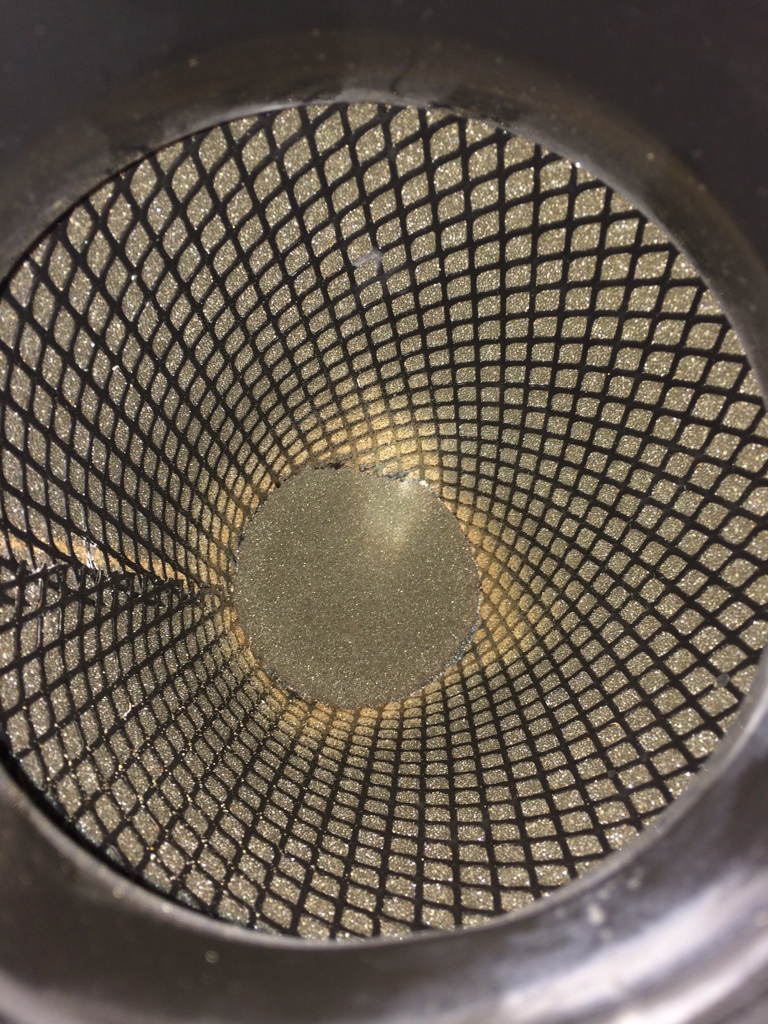

My revolution / pipercross filter has now killed it's second maf sensor. The foam filter is disintegrating and there's all kind of dust and crap inside my intake / MAF housing.
Does anyone have a suggestion for a replacement filter element? I want to keep the intake obviously but I need to get rid of this damn foam filter - it's now caused two breakdowns!

I bought it second hand. It's a dry filter.
I've done about 1500 miles since fitting. First maf failed within 50 miles of fitting, and the new one failed today.
Looking inside the maf housing and intake pipes it's got a lot of dust/dirt in there. Certainly more than I'm happy with. I'm guessing it's the foam degrading, but it might just be actual dirt and dust getting through the filter.
No - I've not spoken to revolution because it only happened (this time) this afternoon

There shouldn't be that much dust getting through. Maybe you have a faulty or worn filter and an identical replacement might do a better job? Or is it not fitted properly and theres a little gap at the side letting in air un-filtered?

Yes as Mike says, check fitment and all's well there, take it off and hold it up to a bright light and this should show where its breaking down
I think I will take mine off and check it out too, before if effects the MAF

It was fitted by MRC - I'm hoping it is fitted well. Certainly seemed sealed before I pulled it apart.
If I hold it up to the light it's kind of translucent more at the end than at the sides. Perhaps it's that.

Re: Revolution / pipercross filter replacement
maybe its just really dirty and pulling dirt through.
any pics?
i leave mine in a bucket of hot soapy water for a few hours then plunge it in and out , the water is usually filthy
any pics?
