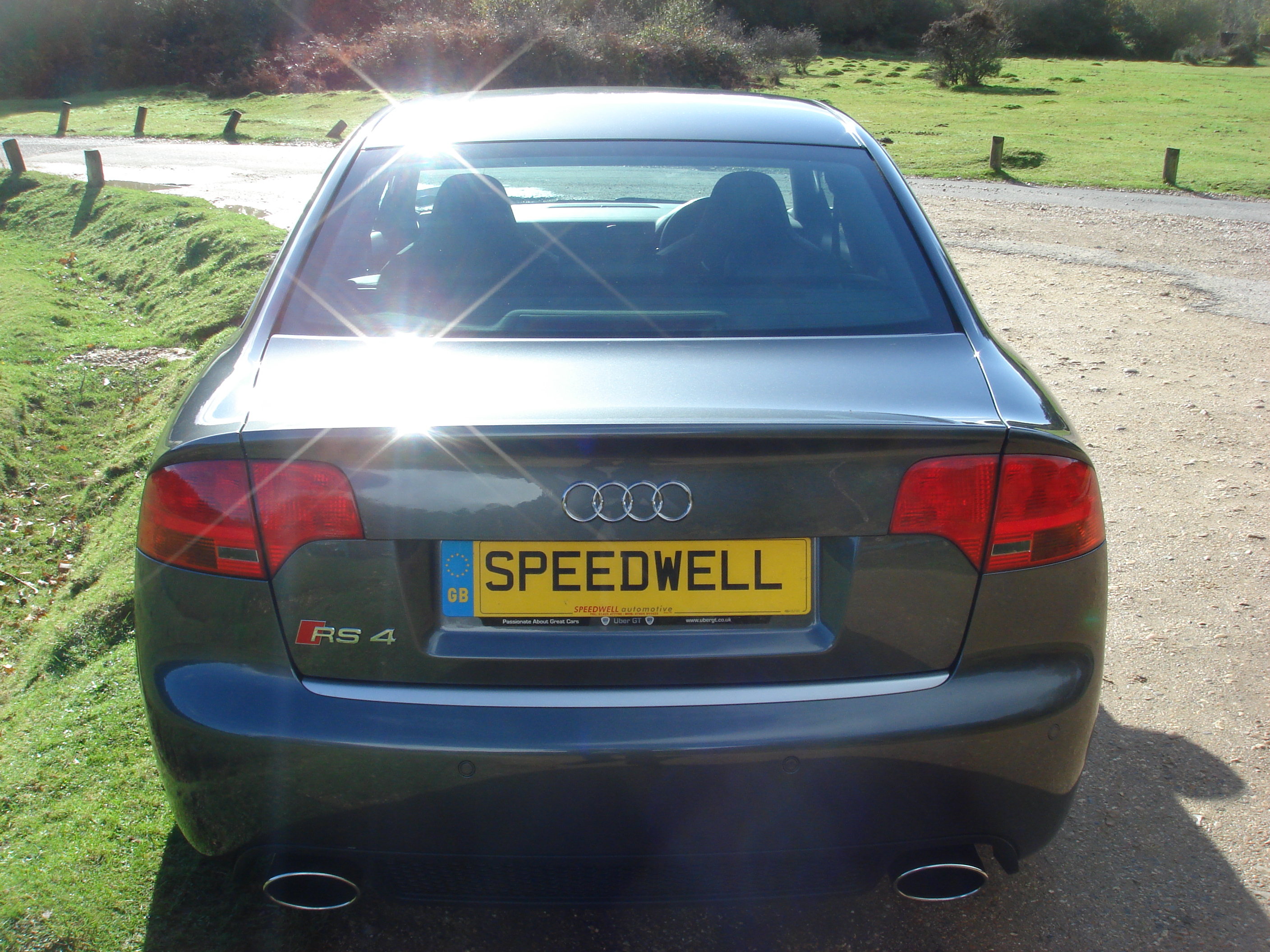

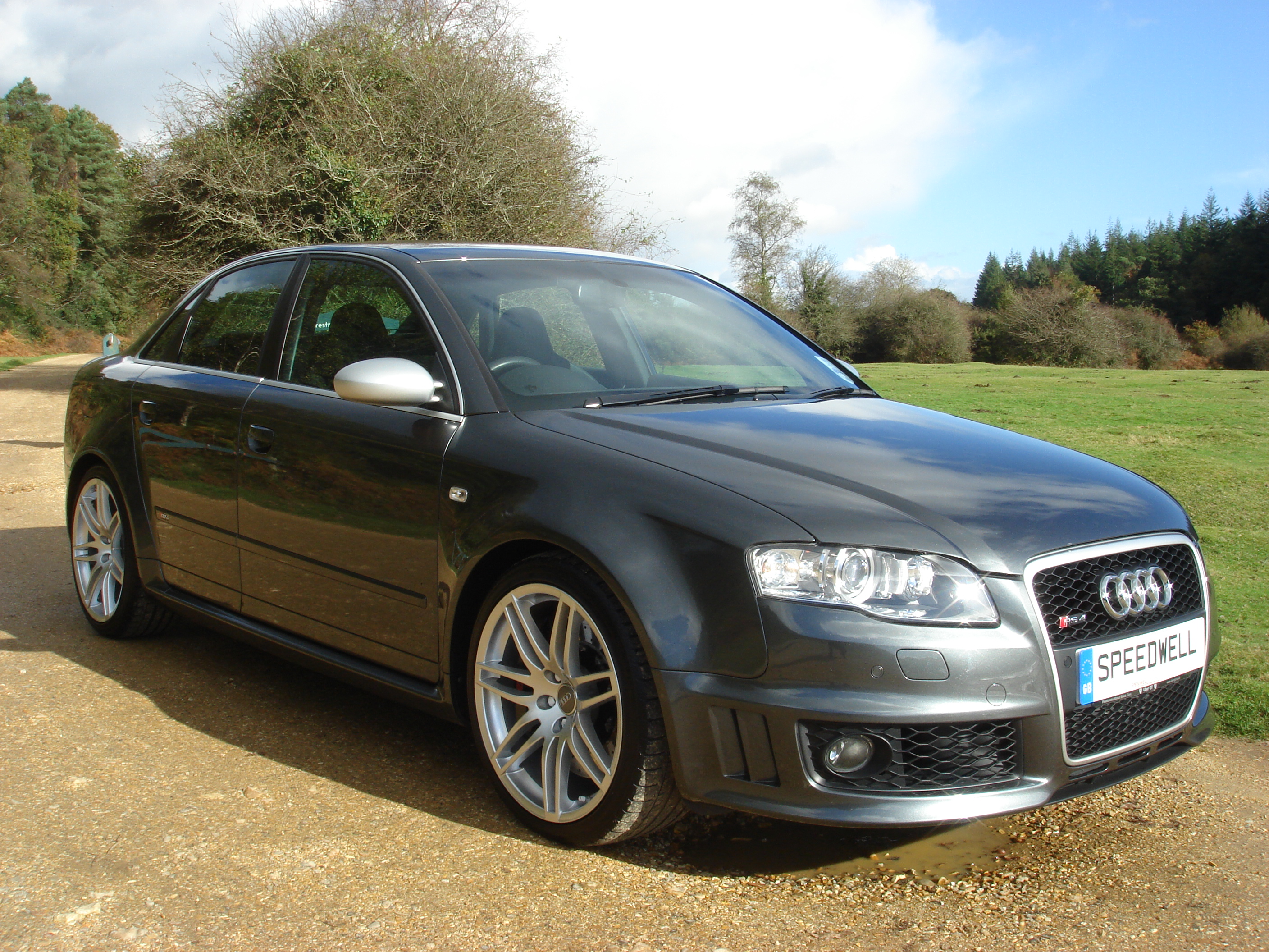

Picked it up with 49k on the clock and in immaculate condition, inside and out. Came from a MKIV Golf R32 so quite a big change to say the least!
First thing on the list was a non res miltek, what a glorious noise that is! Thats all i have got round to doing atm but ive got a few more bits id like to do. Spacers is top of the list right now!
OK, rule number 1, heres some pics!
