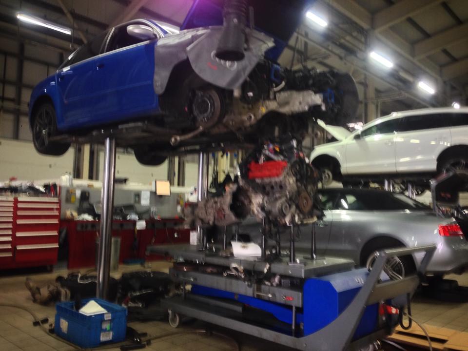

car drove on as new (as always) got back to the yard few miles away...wouldn't start on the truck...rolled it off...started but with the worst miss firer ever :shock: thinking possibly dodgy air mass or fuel or something simple switched it off and started few times and the same every time...the last time tried to start it nothing....took it to Audi next morning...ENGINE SEIZED :thumbsdown:

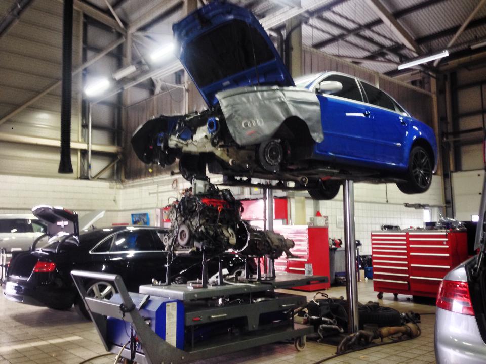

took the engine out.
turns out the chain guides broke up and snapped the chain and the small bits of metal has went through the engine :boohoo:

Be interesting to see photos of the damage.
I can't see how the timing chains would put a hole in the engine.
Sure, would cause pistons to bend valves but not terminal.
My thoughts are something else broke in the engine causing something to sieze. This prevented on aspect of the timing chain to move but crank still turning causing them to fail.
Still a very unusual failure. I would guess that the goodwill is also there to take ownership of the failed engine back for analysis. If you paid for everything they'd not be able to find out what happened internally (as it's still your engine after all!)

it didnt put a hole in the engine tho.
it smashed the spark plugs and the valves were sitting on the pistons im sure they said (not them all)
they had to remove the engine and open it up to find the cause. as Audi UK wanted to know first.
yep would have been its still in Glasgow just now alotho i am also in there everyday (not normally with my own car tho lol)
its just a like for like engine im sure 13k they said at cost from the factory plus fitting and old 1 out :dung:
