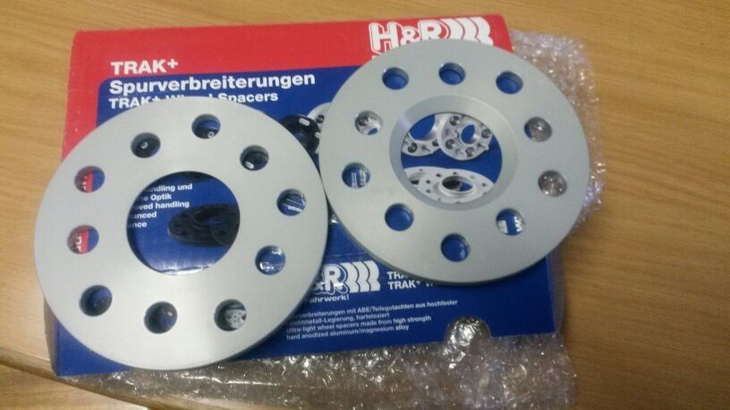

they are not right, they need a lip for the centre of the wheel to locate onto,
like the top ones in this pic
when you tighten the first bolt especially as you have tapered nuts it will have pulled it over to one side making the wheel not centred and then vibrate

Rick_RS4 wrote:they are not right, they need a lip for the centre of the wheel to locate onto
+1
Hub centric spacers have a lip for the wheel to sit onto, which also takes the static load off of the bolts.
Take those spacers off straight away, and get some proper hub-centric ones (e.g. from Virdee).

The 8mm ones you had look to have no lip either Rick?
I've got some 8s same as the ones at the bottom in the above pic to go on up front which I haven't fitted yet but after reading this I'm having doubts.

CellDamage wrote:The 8mm ones you had look to have no lip either Rick?
the ones on the right in my pic were 6mm with no lip you need

Post by Rick_RS4 » Tue Mar 11, 2014 7:33 pm
i originally had 6mm non hubcentric on and they wobbled at speed, the wheel didnt mount to the hub, not enough hub stuck out and the wheel is tapered and not 57.1 all the way to the edge, if it was it would be ok, but then i bought the 8mm ones which were hubcentric and it was fine
the 2 part numbers i gave were totally fine for my car no issues
