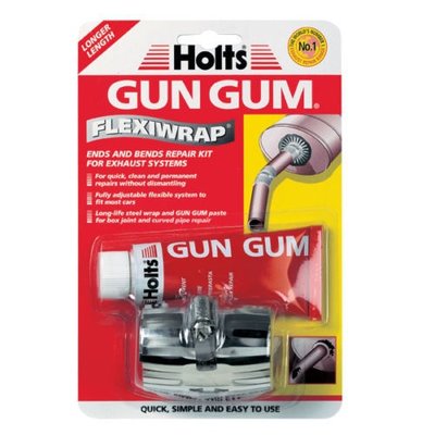

Post by sckrs4 » Thu May 08, 2014 9:21 pm
Is this any good for a quick DIY on the flexi portion?
sckrs4
Posts: 175
Joined: Mon Apr 20, 2009 10:42 pm
Re: Damaged looking down pipes
Post by sckrs4 » Thu May 08, 2014 9:49 pm
Rick_RS4 wrote:same thing has happened to mine i think its speed bumps, the problem about fixing them is the size of the standard audi pipe, you might have to get a piece stepped up to 2.5'' for the flexi, then back down to the catback
Is this any good to fix ?
