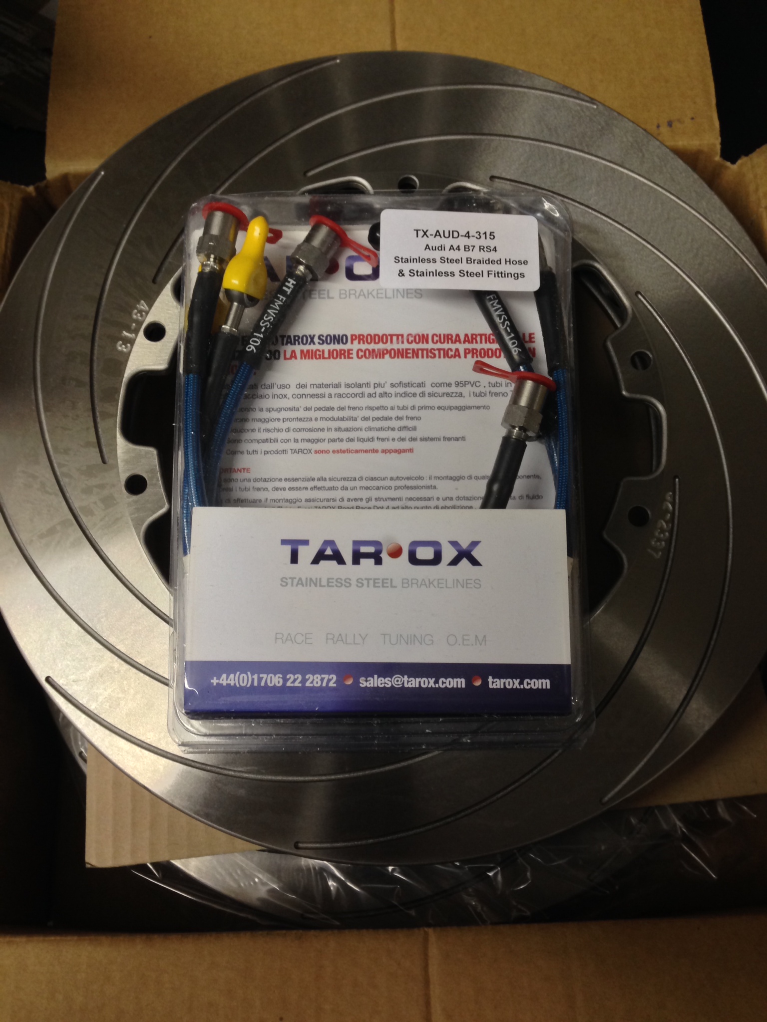

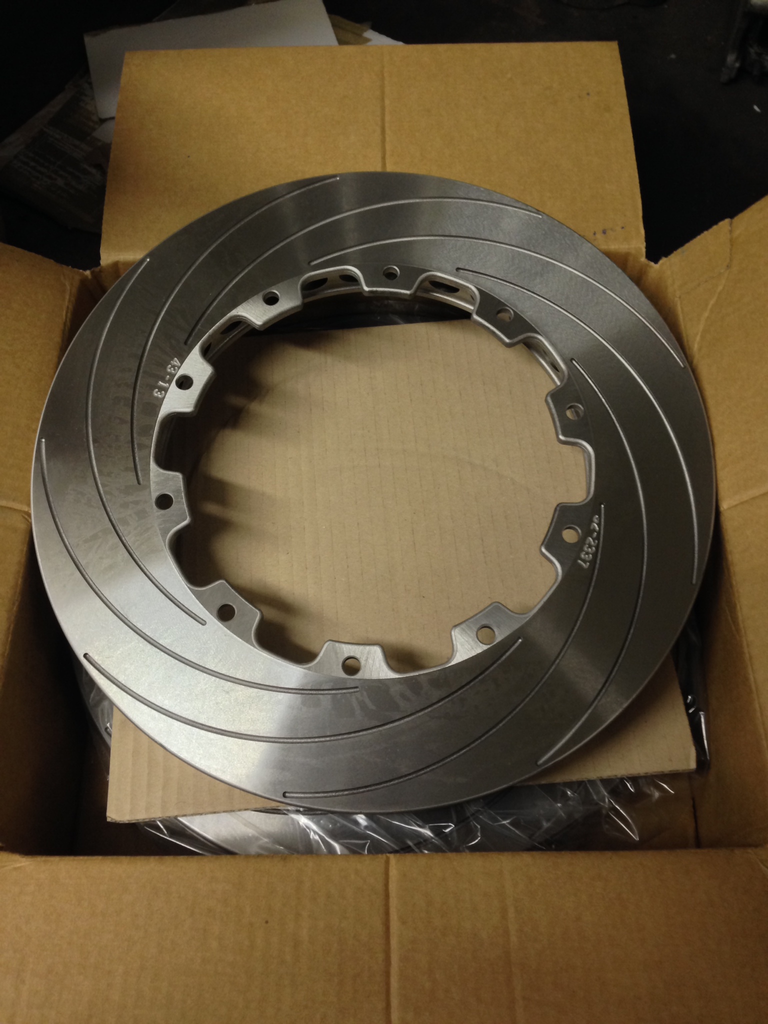

I Have just bought Tarox G88 discs all round which are 2 piece bell and rotor both front and rear. Road race pads all round, uprated brake hoses and road race fluid.
They have an excellent guarantee with them against warping and cracking ( which the Audi discs did on my car).
Really helpful knowledgable sales manager.
all prices + vat
Front disc set £520
Front pad set £200
All being fitted tomorrow. I will update you on my opinion once bedded in.

I have now bedded in the G88 pictured above and can honestly say they knock spots off oem, this might also be due to everything else being changed though.
