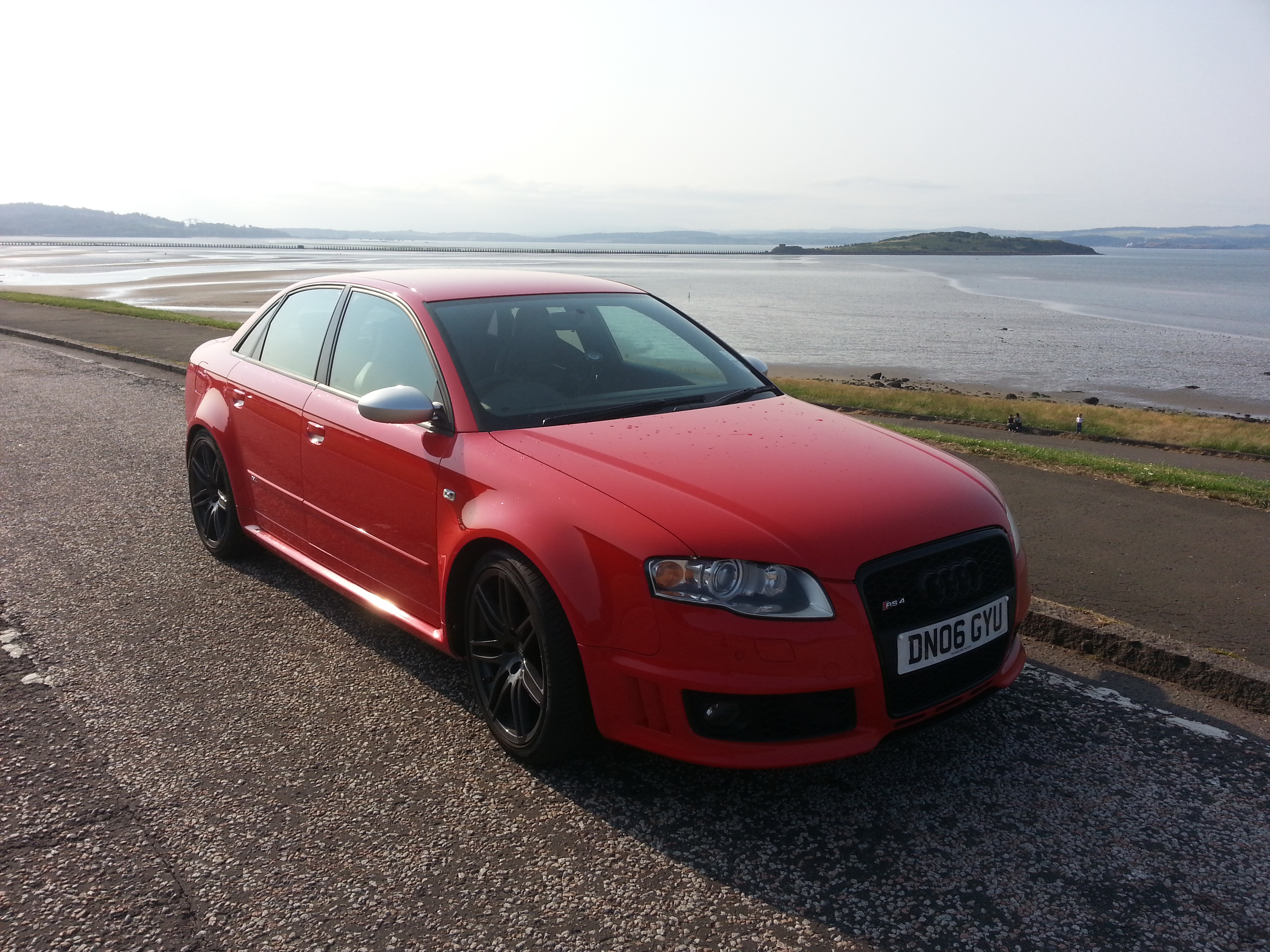

attached a lovely sea side photo for you lol
