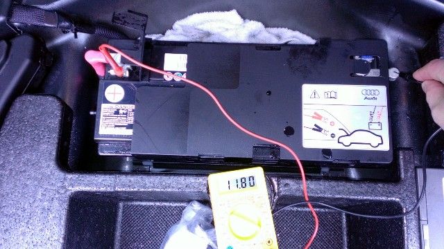

I'm getting 11.80 from my multimeter I'm not sure how that compares to a decent reading. it's on the original battery. And as you say the car doesn't bother to try at all.
Whilst getting to the battery I've found water in there. There is moisture under the plastic cover and a few mm gathered in the well underneath the battery............... Not sure that's related to the starting issue but is something else to sort out, perhaps I'll start a separate thread for that.......

11.8v sounds like a fairly heathy battery to me - they normally lose a cell at a time when they're on their way out so you'd expect it to have dropped to circa 10v

put the meter on the battery and try to start it
have someone tell you how low the V goes (unless you can do a min/max on your meter)
