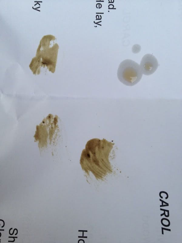

Pretty sure it's oil that's leaking
The two smaller dots are drips off the end of the power steering fluid dipstick and the smudges are from me wiping my fingers under front of the car.

Batfinnk
Posts: 794
Joined: Mon Sep 24, 2012 10:52 pm
Re: These oil leak threads are popular. Here's another.
Post by Batfinnk » Sat Jan 26, 2013 3:34 pm
Might sound stupid but smell them. They both have a very different smell.

joesnow
Posts: 216
Joined: Wed Sep 12, 2012 9:06 pm
Post by joesnow » Sat Jan 26, 2013 3:53 pm
Will give it a go. When I was under this morning it definitely smelt like oil but then I don't know what power steering fluid smells like.

adsgreen
Posts: 5571
Post by adsgreen » Sat Jan 26, 2013 4:03 pm
Iiirc it's hydraulic fluid and smell le piss. Sniff the filler cap.

Timster wrote:Who's Carol ?
Carol Service. Scrap paper found in the boot from my lads preschool Xmas show.
I even thought about ripping that off cause I knew someone would mention it :beerchug:
