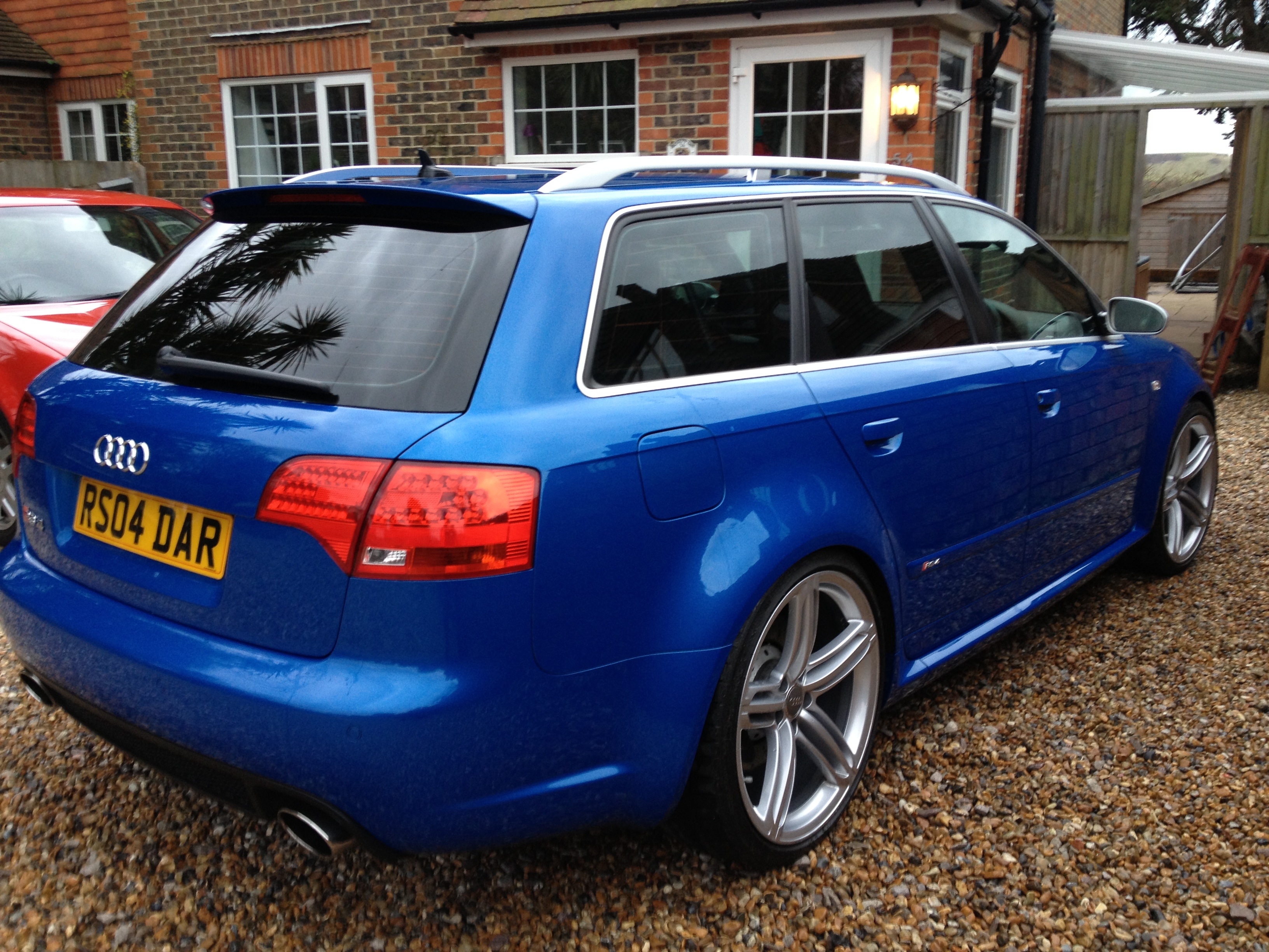

Post by dazie00 » Fri Jan 25, 2013 7:33 pm
Are these the 20" style wheel u want, if so ill be selling these soon , I had 10 on rear and 11 on front spacers

audi rs4 avant sprint blue , buckets ss+ fbsw rs6 alloys ,10/11 spacers ,rear LEDs

dazie00 wrote:Are these the 20" style wheel u want, if so ill be selling these soon , I had 10 on rear and 11 on front spacers
Dazie, I assume you meant 10mm and 11mm spacers and not 10" and 11" wheels!?
dazie00
Posts: 94
Joined: Tue Sep 25, 2012 7:40 pm
Location: east sussex
Re: 20" v 19" wheels debate
Post by dazie00 » Fri Jan 25, 2013 9:32 pm
That's right mike ,20"x 9.5 I think Rs 6 alloys, spacers 10 mm rear 11 mm front , with tyre pressure sensors and 2 michillin 265/30/20 in as new condition and can supply 2 brand new as well.all long bolts and locking wheel nuts as well

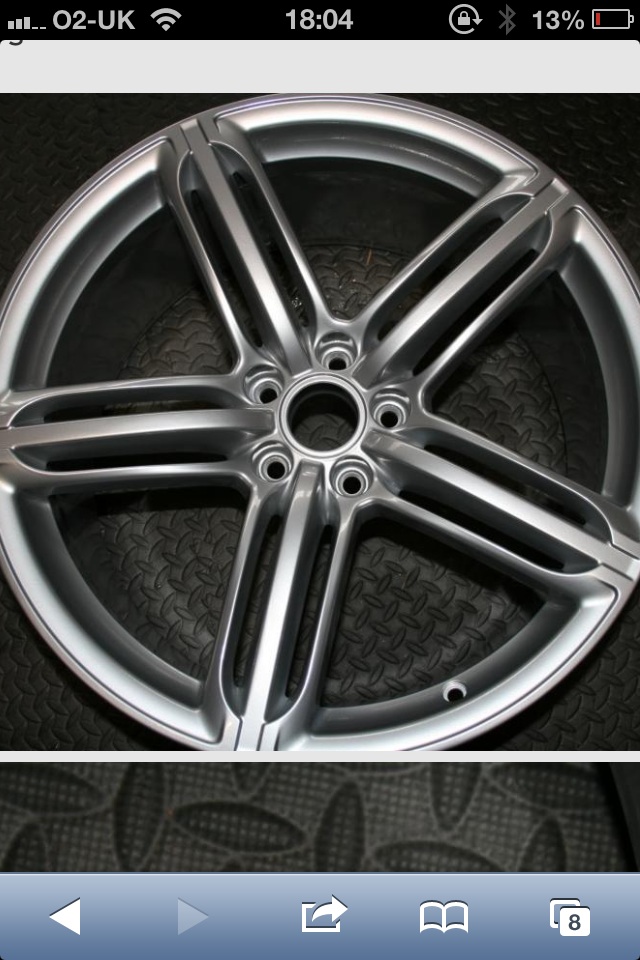

Nope - I am looking for some of these - but still not sure about tyre sizes/spacers/adpators as they are 20x10
