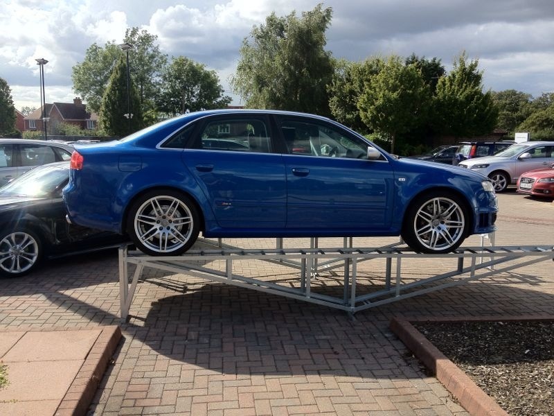

Post by Rs4mar » Mon Dec 31, 2012 10:04 pm
This is before the oil issues

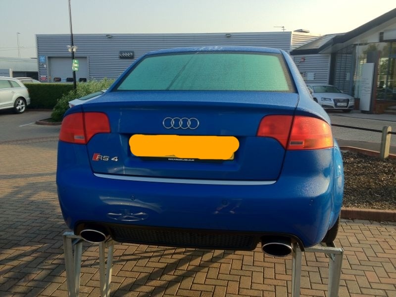

Post by Rs4mar » Tue Jan 01, 2013 12:17 pm
And another one
