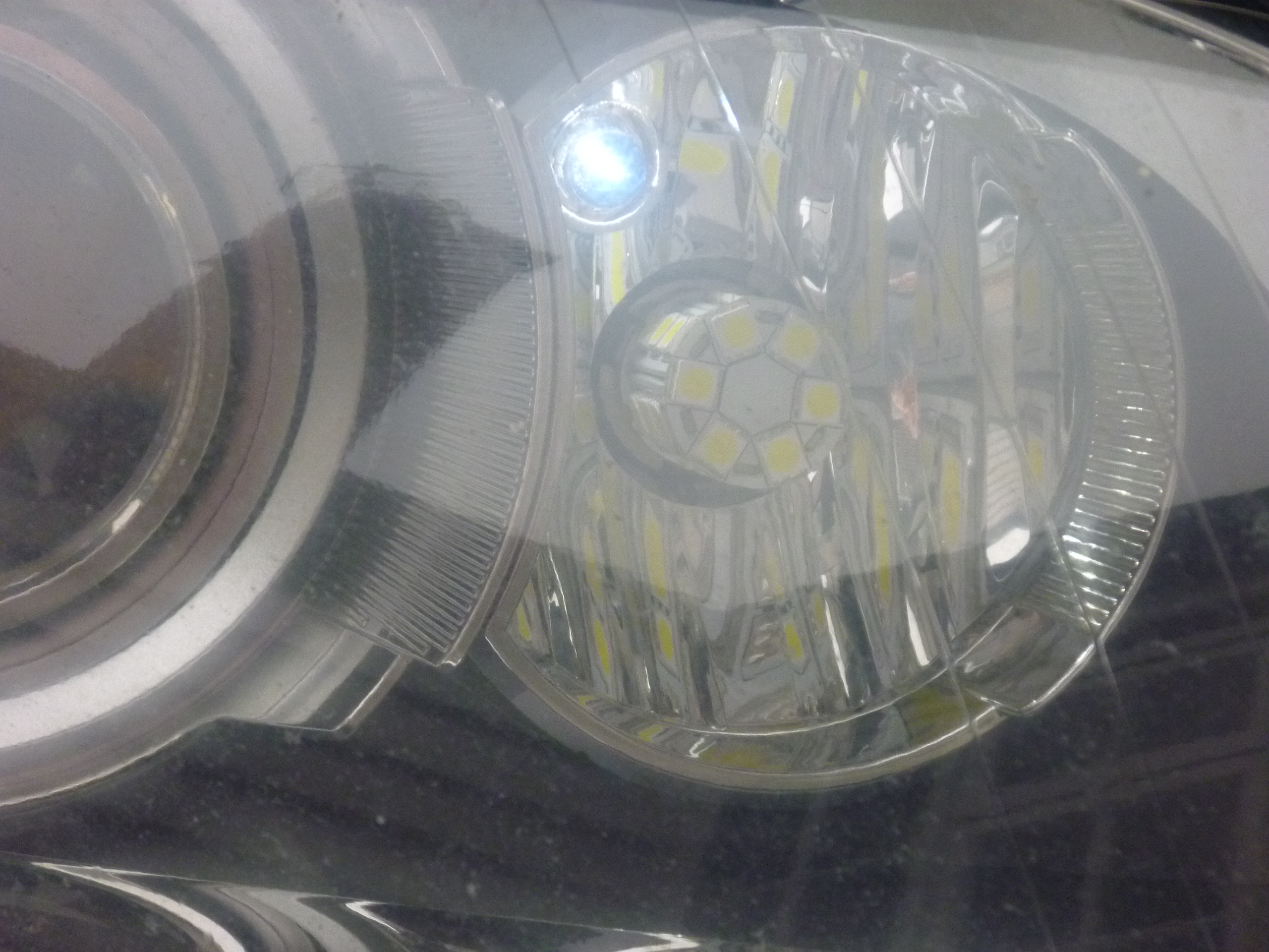

The mtec w5w is just a blue coated filament bulb as I was describing - that's what I fitted after a couple of fails with LEDs - it's close to xenon / LED colour temp' when switched on at night:
As MB2 says, if you really want LEDs, best wire in some resistors and then fit whatever LEDs take your fancy - but if I were you I wouldn't wire them in inside the headlight housing, because they'll get hot and might melt something expensive...
