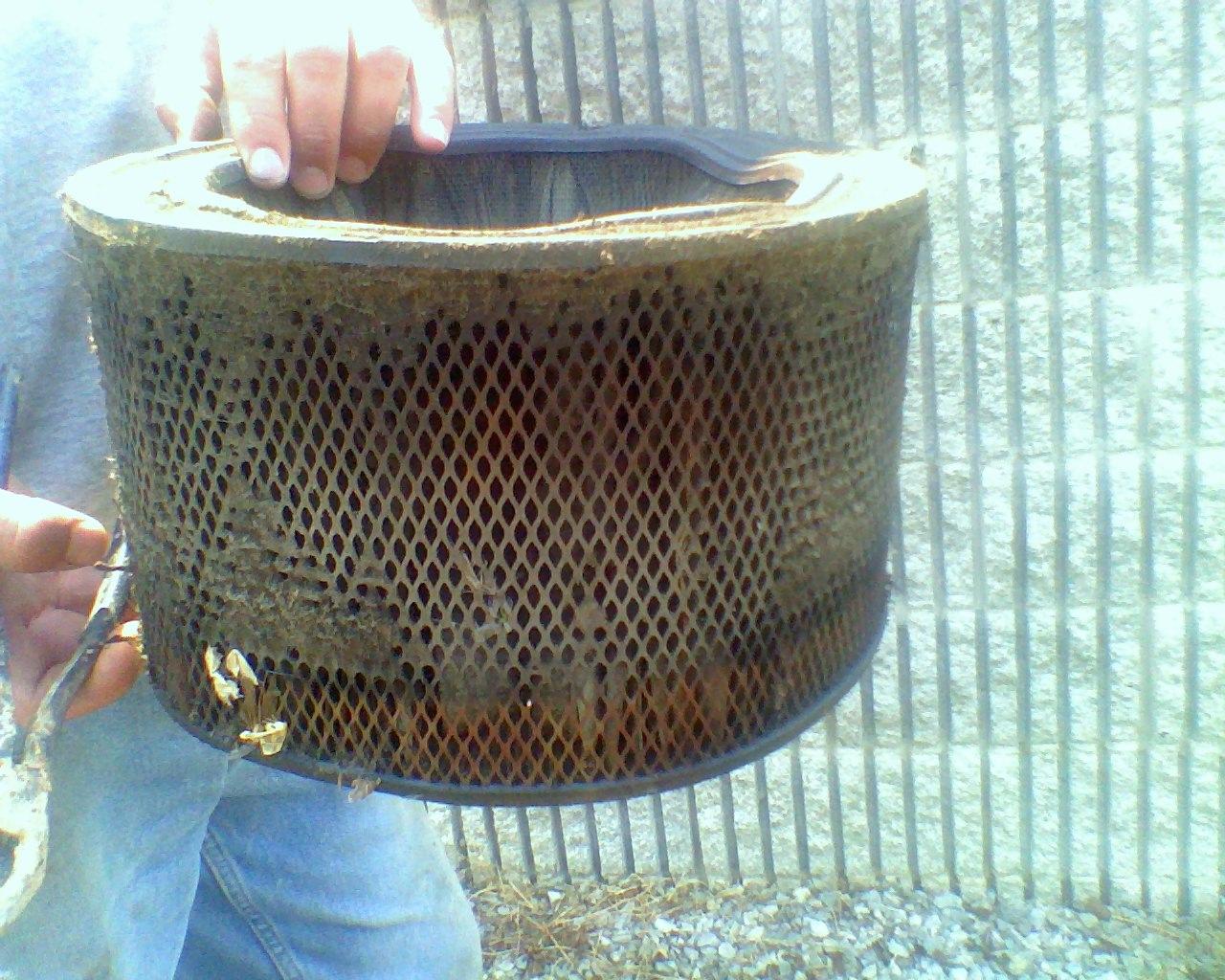

an airfilter can make a big difference...
side story, last week:
I had a 20HP Roots aeration blower...
rated amps ~49, was reading 58, ~ 24HP, overloaded
discharge pressure was 4, my calcs said it should be at 5.5/17HP/40A
motor speed ~ 1760
blower speed ~2100
looking at the blower curves it said the pressure should be >8 psi (gauge read 4!) at that HP
after scratching my head, I had him change the inlet filter:
P 5.5 psi
17 HP
40A
the filter had > 2.5 psi of drop! and sucked up 7 HP, ~25% of the load
this alone will reduce the power bill by $450/month...
my guy sent a camera pic
