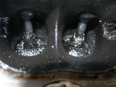

OK, I see that but then I see all the photos of the valves clogged up etc on the cars that have not made good figures on the Dyno.. In some cases of course it has been something to do with the air box power flap??? Does that make sense?Terry1948 wrote: I have no faith in rolling roads so it would be pointless for me to go down that road.

the 'valves' are not 'clogged up'..it is physically impossible to reduce airflow
-the velocity will increase as area decreases, net volume the same
-the circular valve opening <<< cylinder formed by the valve lift
so it is not the limiting factor...I have seen accel numbers where UNCLEANED cars are faster than cleaned ones...
BS (again): Audi has never acknowledged a 100% fialure rate re: DRC
only <1% of the cars have had components replaced...
carbon deposit = natural = non-issue = 0 power loss
you are making things up, again...

Suffice to say, that an engine whose internals look like this after 3000 miles isn't going to last as long as a non-FSI engine with no deposition on it.
Anyone who thinks it is is smoking crack IMHO.
The engines ability to flow air is compromised by this deposit inspite of what others say. They have probably never bothered to hook VAGCOM up to their engine so how could they ever know?
Granted it is not a huge percentage, but you are right...that isn't the point.
I can't be bothered to crunch the numbers but the difference between a car running 12.8 and 13.2 is probably 40hp so a car running 13.2 is down on a car running 12.8, correct? Thats incontrovertible.
But from my point of view, the clue is in the patent involving technologies to try and mitigate this effect.
De facto, this is an issue, and the technologies to combat it are still in their infancy.

deposits cause no power loss, period...it's a basic fact
of course there is a difference between 12.8 and 13.2, but the average for an RS4 is 13/110/4100 lbs loaded
what is 'crack'? do you smoke it?
Porsche has made their flagship DI, as will BMW on the next M5
so does Ferrari
the patent stipulated methods to mitigate the natural propagation in DI engines, and it is effective as demonstrated by the times...
people with 50k miles and uncleaned are running as fast as people with 25k miles and cleaning...proof there is no impact
it flies in the face of the physics of flow to think that valve deposits in any way can inhibit flow..it's impossible...end of story...I ave proved it with basic math, and was confirmed by a PhD in fluid dynamics...they can't...
the issue with deposits is that they absorb fuel, causing a time delay or lag in the process...this does not affect DI engines, an advantage
