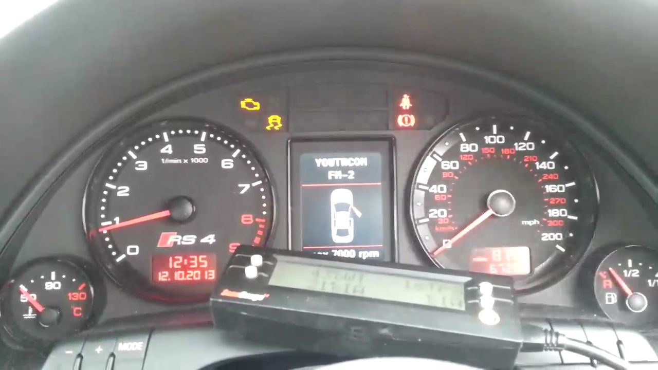

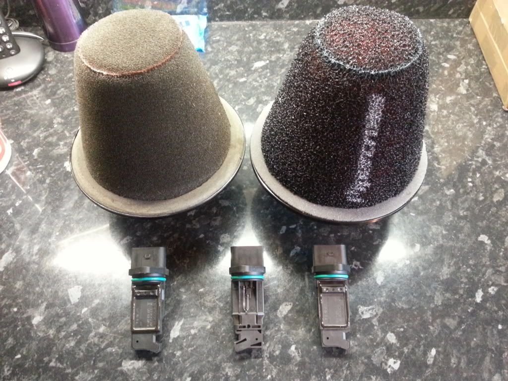

Well here we go again!! New MAF arrived today so fitted it along with my new Pipercross Dry filter. All went well with changing it over i should be a pro now as i have done it a few times.
My orginal MAF and 2 replacements...
And clearing the codes after fitting. Before the new MAF was fitted these lights would pop up as soon as the codes were cleared so deffo the MAF.
