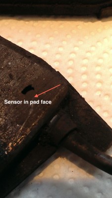

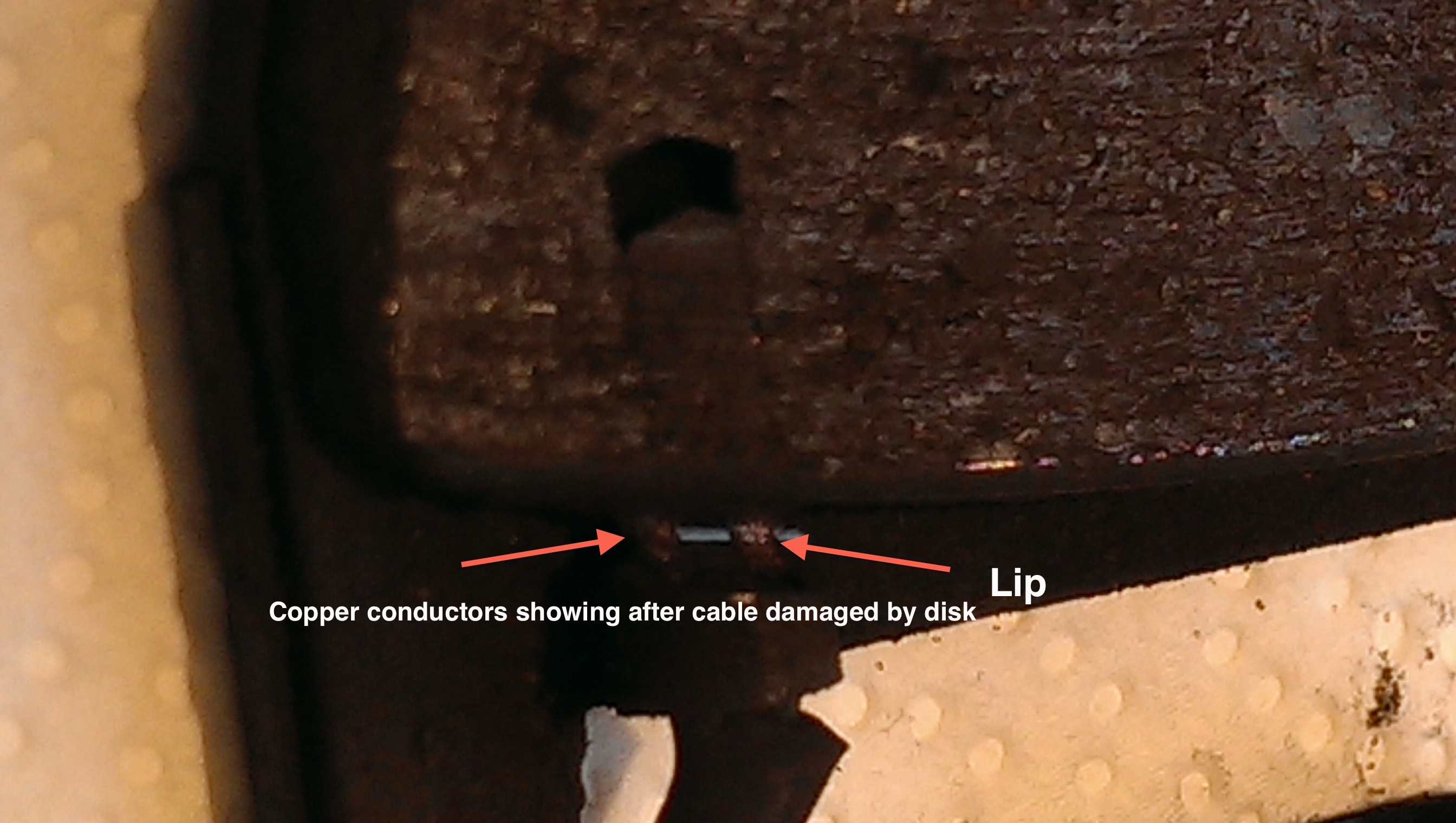

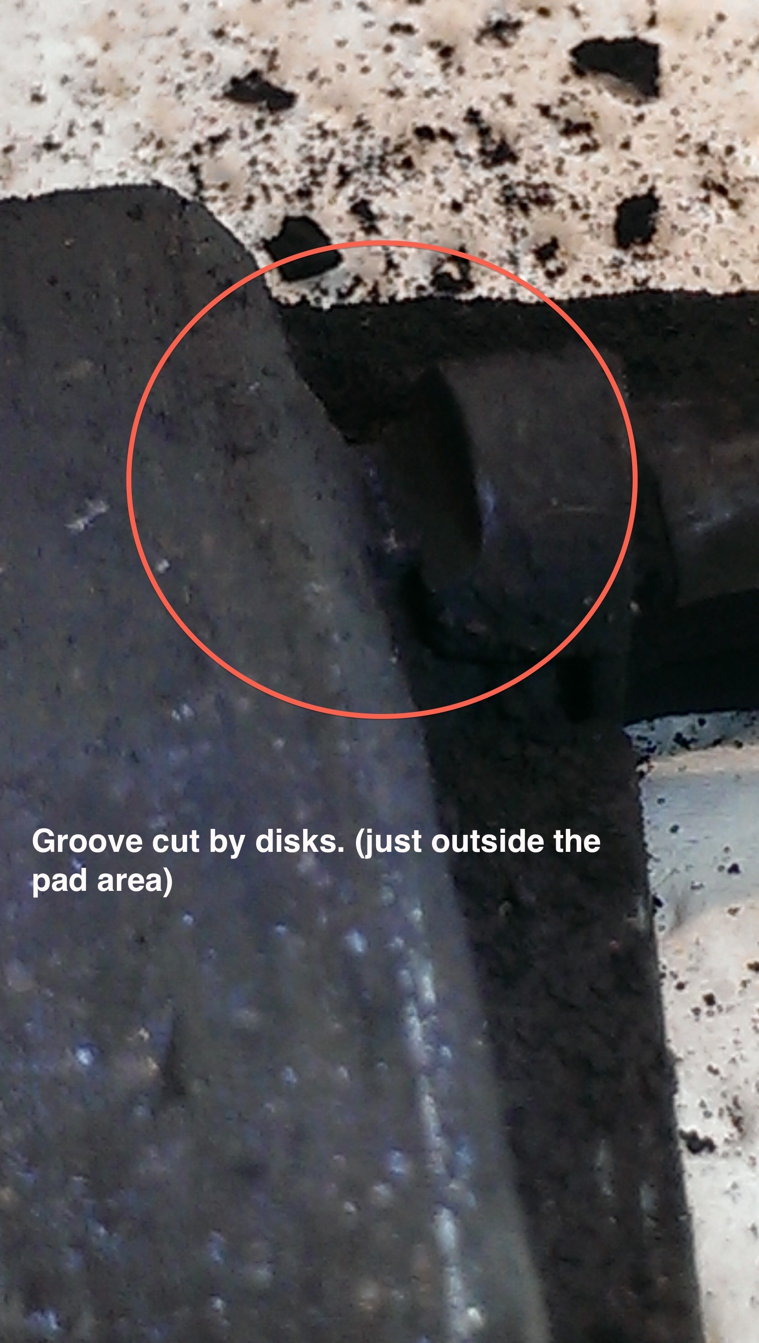

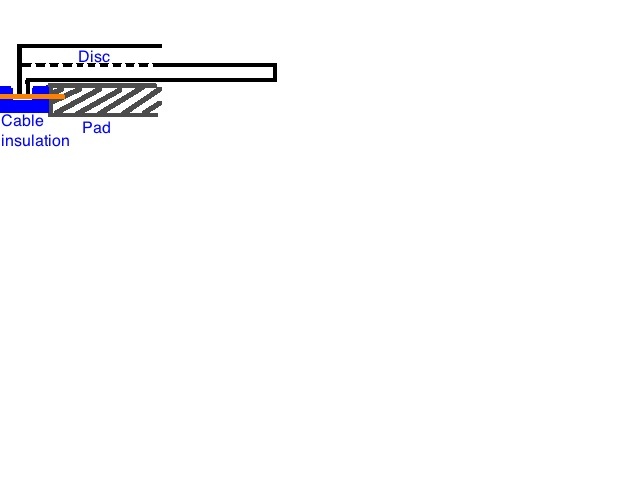

Images show the groove cut by disk-lip, through the cable sheath and into copper conductors.
My theory being that the lip spinning within this groove "could?" be the cause of vibration.
Apologies for image size... click to see full resolution.
The pad surfaces themselves are actually in pretty good shape with little/no crumble and zero scouring.
(sonny, look and learn ;-) )
Section. You hopefully get the idea
