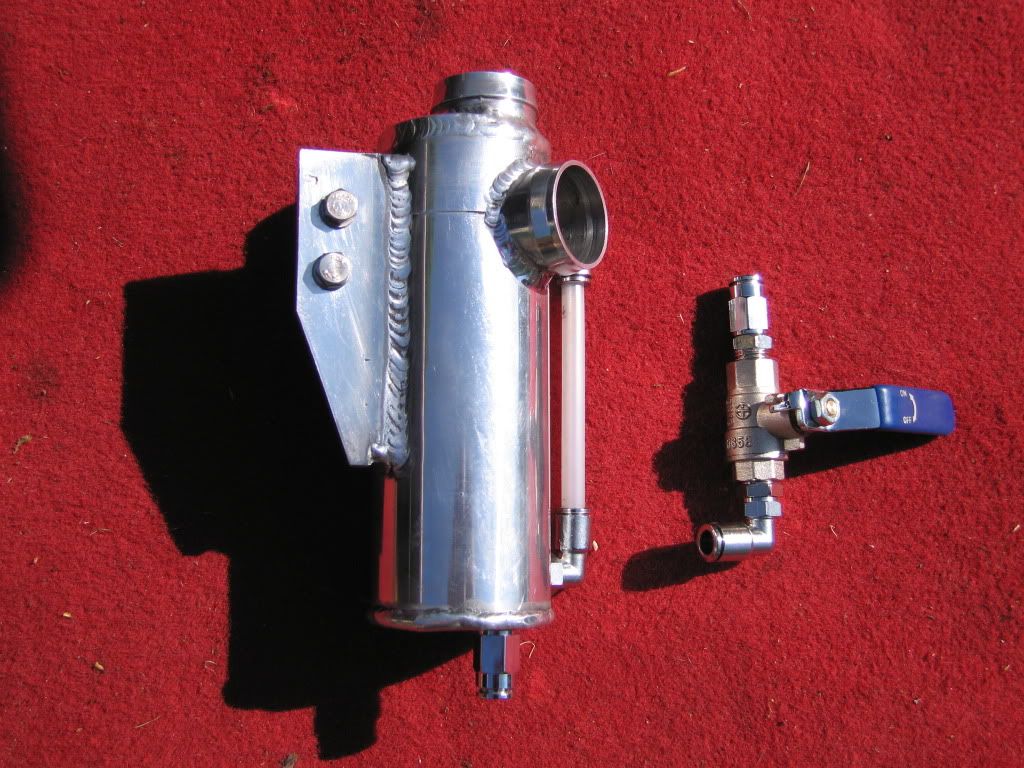

just some comments:
after the cleanup....two solutions
- install a catch can and remove the stupid part from Audi (and close the pipes as well).
- keep the audi part in place, so it will "act" as a catch can but close the main pipe (so no vapor oil coming back to the admission), so no need to worry about the a catch can installation.
caldy
Posts: 681
Joined: Mon Nov 05, 2007 7:31 pm
Location: God's Country
Re: Another stake in the heart carbon naysayers
Post by caldy » Tue Nov 06, 2012 12:27 pm
Already tried a catch can - doesn't catch anything worthwhile.
