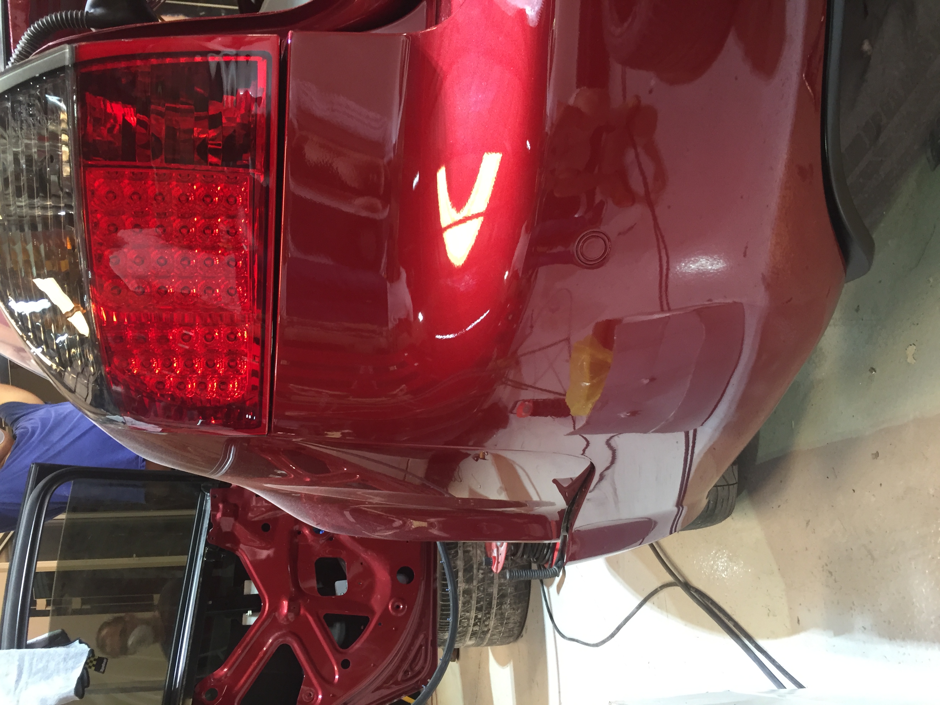

iconic78 wrote:Image
I'm sure you already know this. But outer B7 tail lights are *not* the same as the B6 tail lights
*even more confused.com
Be confused no more young jedi! lol
Thats why we grafted the B6 rear quarters in to the B7 quarters whilst retaining the RS4 arches. So B7 lights will no longer fit.
The same applies to the front end. As we progress with the reassembly, youll see what i mean from the photos.
We are still painting various parts. Also just discovered that to install the chargecooler, we have to cut more away...and we just painted that part of the car! :-( So once cut we will have to paint again.

iconic78 wrote:
Ahhhhhhhhhhhhhhhhhhhh. That makes more sense. :beerchug:
Thought from the photo you'd just bolted the entire rear three quarter on, judging by the weld line highlighted:

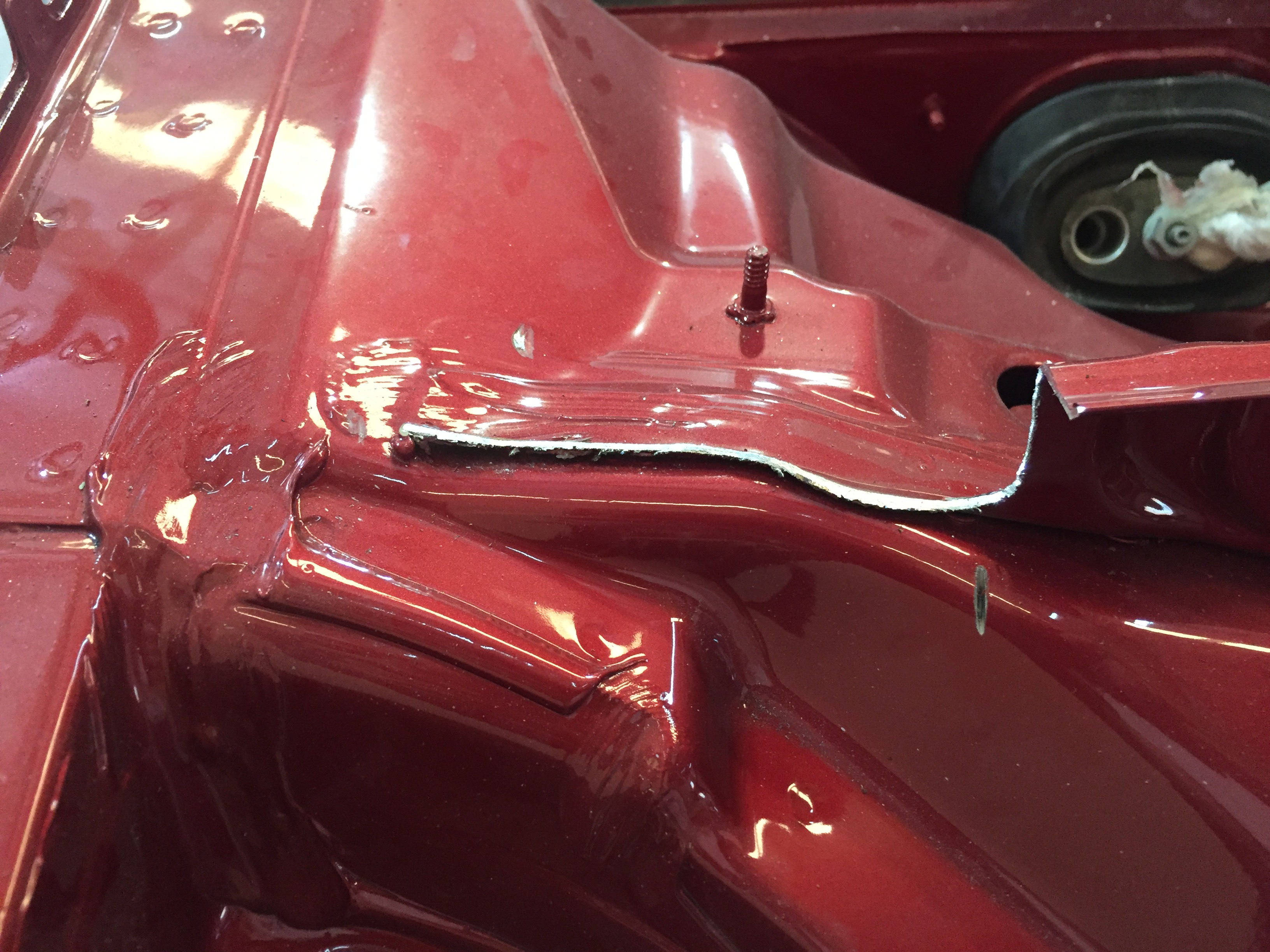

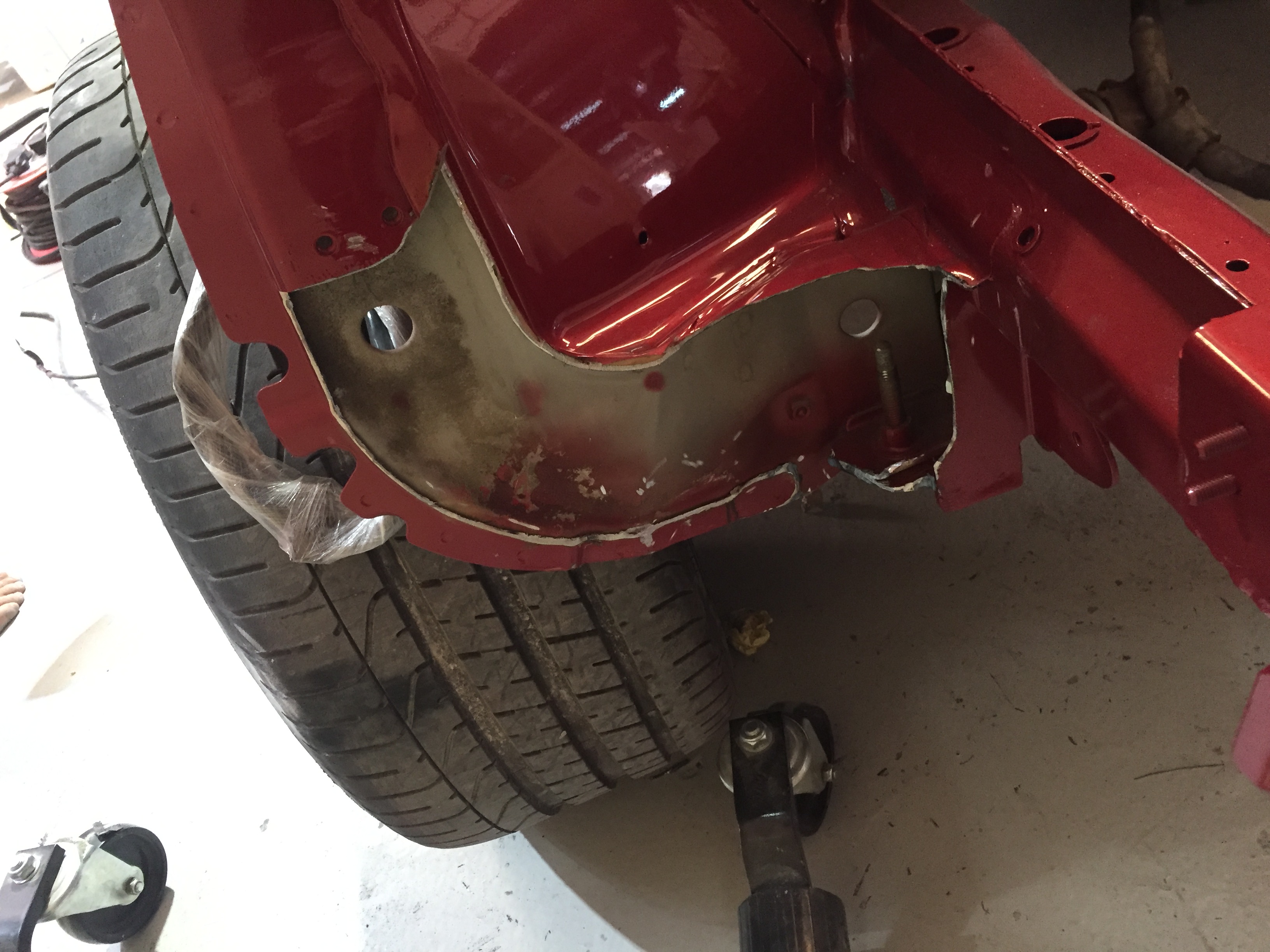

So we finally cut out everything that needs to cut to make way for the addition of the chargecooler(all part of the stage 1+ kit) and its water pipes. Now have to paint those areas. You see the amount of room that is needed and what we cut away.
All being well, once the final parts arrive from Jhm then can finally put the engine back in. Interior is another week away due to some changes that i made.
The carbon fibre boot has proved to be a pain in the rear due to the fact that it needs to be modified to fit.

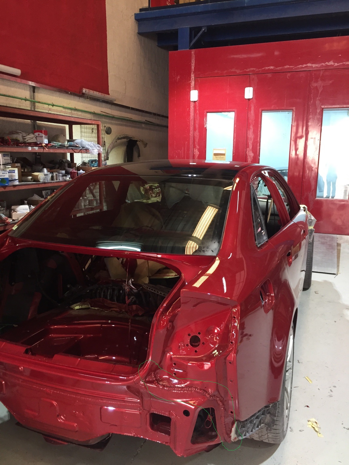

Hopefully this will give some indication of the direction we're heading in. With the engine out, there's nothing to show on the front end...yet!
