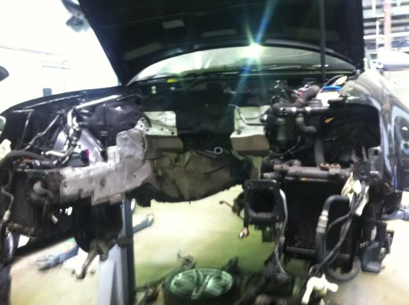

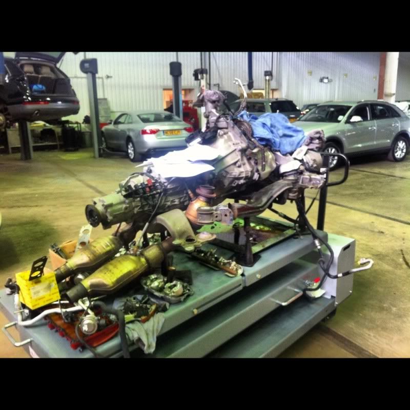

As a quick update to the thread, the engine's now right out of my RS4 and the heads are coming off. I've seen pics of the carbon build up numorous times before from the top down, but looking from under the cylinder head it's an absolute Blimmin mess

Quick update
Spoke to Audi Swindon today, who have sent the heads off to a company called South Cerney Engineering. I know this company myself and their work really is second to none, so at least I know Audi are taking this seriously
In the meantime, the A6 they've lent me has been a really nice car for the 600odd miles I've done in the last week to Newquay and back and looking down to see 35mpg average has taken some getting used to as well
Still, I'm missing my Rs now and I'm certainly looking forward to getting it back (hopefully) next week

Popped into Audi today to see how they're getting along
Heads were enroute back to them fully clean and re seated
They seem to think that if heads turned up later this afternoon that my car would be ready to collect Friday pm. Judging by the state of disassembly of it currently, I think that's a big ask ;
