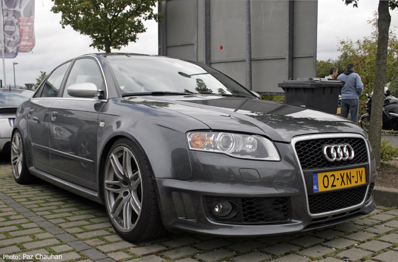

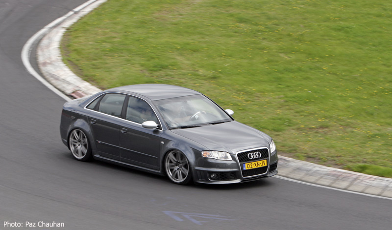

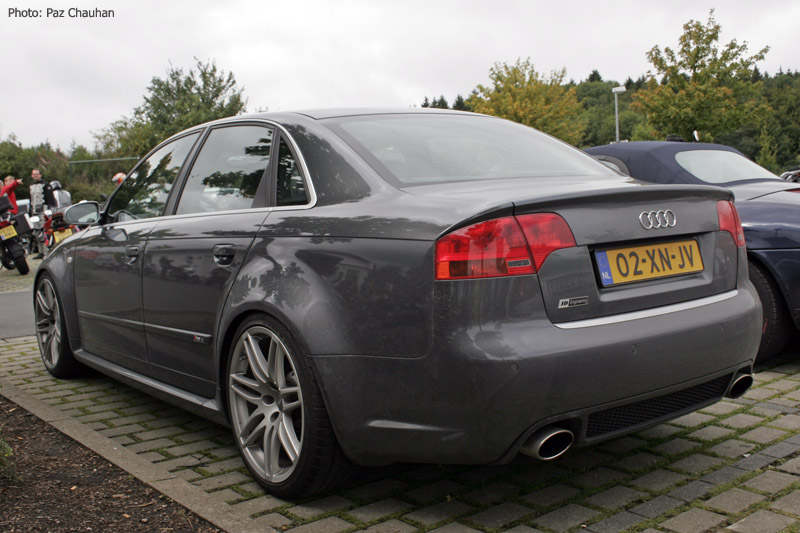

Some pics of JD Engineering's RS4.

There'a JD Engineering badge too :thumb:

Nice touch, not liveried up to the gills merely one ickle badge on the boot lid - discretion is key.
