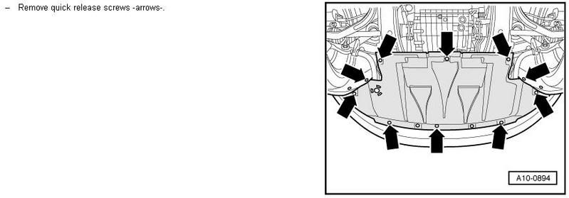

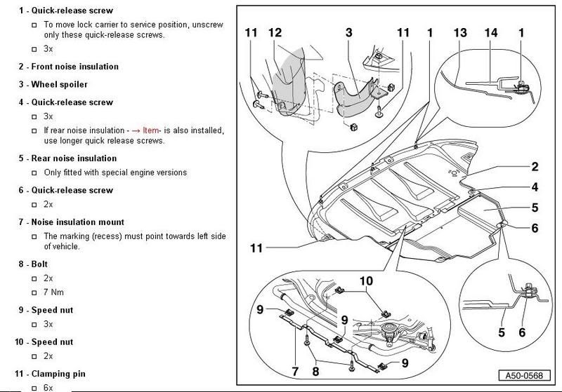

Front undertray:
Yes, there are lots of clips and screws!
Removing is a bit more straight forward?

Post by Daz » Sun Feb 04, 2007 12:15 pm
GlynG60 wrote:Image
Nah, there were more quick release screws that that. There were another 3 recessed one's along the front (but back from the front edge) and another 4 (2 either side of the brake cooling ducts).
Cheers,
Daz :D
Audi RS4 Cabriolet with added Milltek - Gone :(

Post by GlynRS2 » Sun Feb 04, 2007 5:57 pm
Audi obviously think it need to be a bit better secured on the RS4 - can't imagine why :wink:
