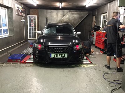

Post by FaisalJ » Sat Nov 07, 2015 10:56 am
2007 RS4 B7 Avant
marc1
Posts: 3289
Re: Putting "Engine Carbon Clean" to the Test
Post by marc1 » Sat Nov 07, 2015 11:32 am
Looks evil! :twisted:

Post by FaisalJ » Sat Nov 07, 2015 2:56 pm
Hey guys, mid play-date at the moment so will post up more detailed thoughts/results later. Video to follow too.
Initial thought, don't dyno your RS4...ignorance is bliss haha.
Car is low on power, 352bhp before clean. Post clean 365bhp. Torque increase seems to be more pronounced.
No bhp increase on the golf or jag xjs.
2007 RS4 B7 Avant
Post by MikeFish » Sat Nov 07, 2015 3:08 pm
That's a nice increase considering your car is sick. The good news is that sounds like its in vac leak territory which is generally not expensive to fix.
