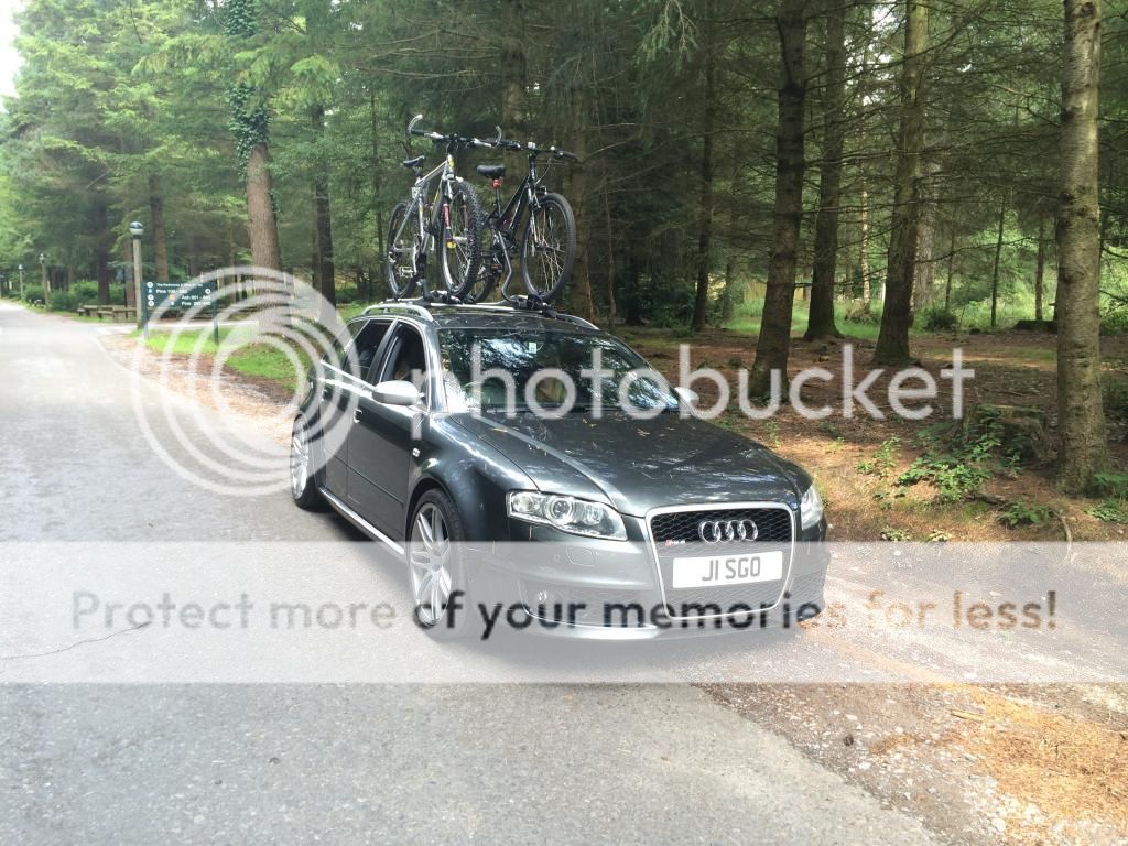

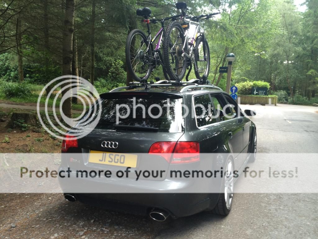

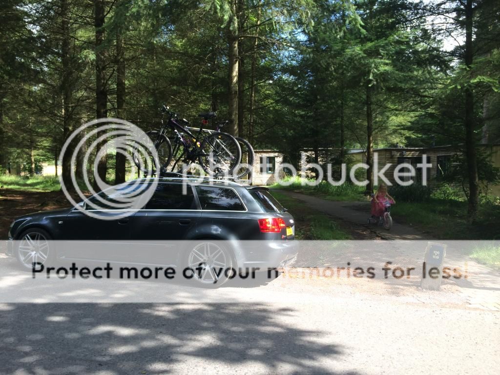

Hi All,
Returned from Centre Parks yesterday, with the car fully loaded to the roof and bikes on top the extra torque was more than welcomed :lol: .
I cannot stress enough the increase in torque IMO, particularly below where the old 5.5k kick was, it was gutless here before in comparison (an opinion also shared by my cousin when he drove it). I can now drive the car differently with less of a need to change down gears.
Anyway a few final RR & leaving CP pics :):
