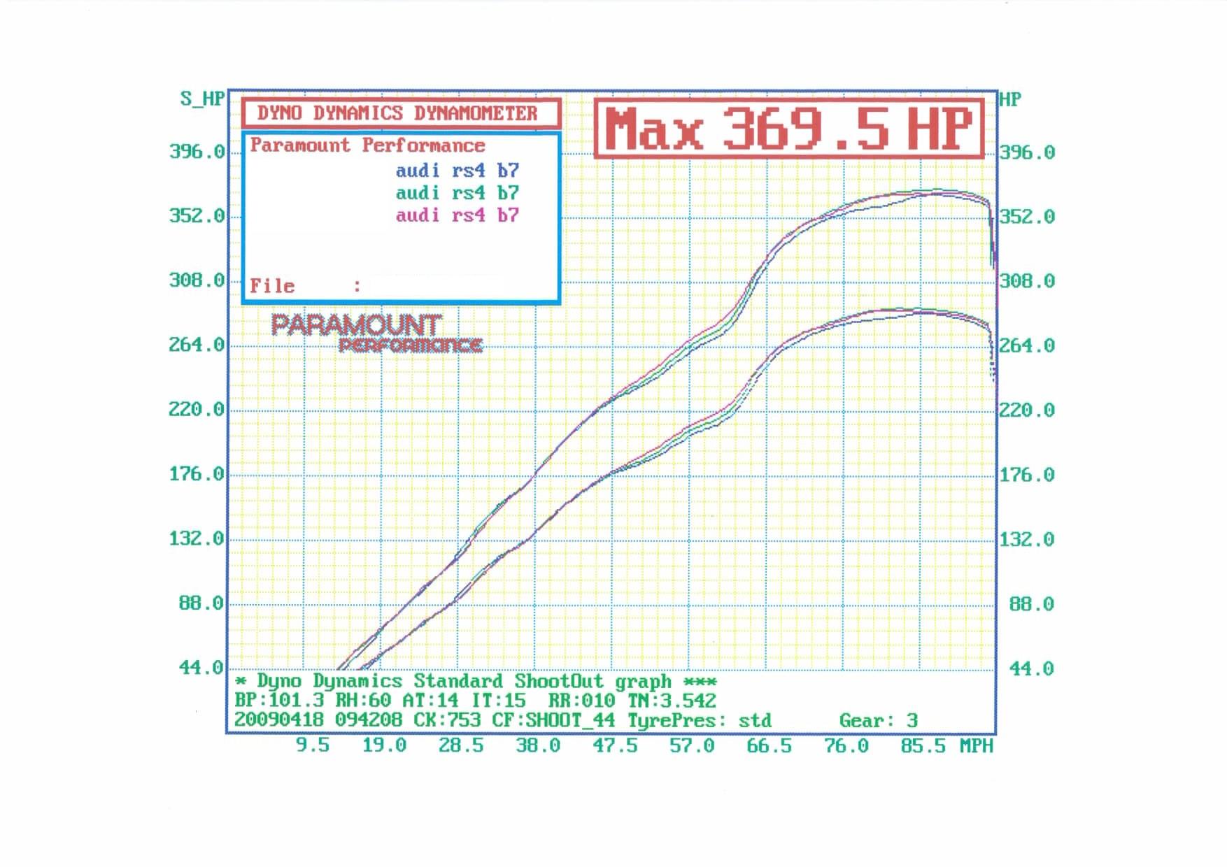

Post by Dom81 » Fri May 22, 2009 3:01 pm
Here's mine

Also meant to say, you can quite clearly see, that apart from headline figures, mine is lacking all the way through, and doesn't have the boost of power clearly evident @5500rpm on other peoples readouts

I've compiled Oli's, Dom81's, P_G's and dubbers into a spreadsheet...
the cf's at 40, 60, 80 and 90 are identical...all at 30%
if it's 30% at 40 mph, it should be a good bit higher at 80, ~sqrt(80/40) or 40% high or 42% or so...
it appears to me, that the raw numbers were calculated from the corrected numbers...and from what I've read this dyno machine only puts out the corrected numbers when in shootout mode...
Oli, what does your car feel like on the road?
any timed runs?
you are 30% down on HP...
the car would be so slow it couldn't get out of it's own way...
the engine would run rough, etc.
all 4 graphs make ~ the same RAW power at 40 mph (145 or so, the lowest being dubs at 140)), the cf's are different for the cars at this speed
Oli 0.22
Dom 0.25
P_G 0.30
dubber 0.29
I used the average of dubbers, since they were so inconsistent...

Dom81 wrote:Here's mine
In terms of how the line is plotted there is little differecne between yours and ine, just the actual max output figure.

ArthurPE wrote: all 4 graphs make ~ the same RAW power at 40 mph (145 or so, the lowest being dubs at 140)), the cf's are different for the cars at this speed
Oli 0.22
Dom 0.25
P_G 0.30
dubber 0.29
You lost me at this point - can you put into (very) simple words please!
Agreed, and many others had exactly the same shape - just not Oli, Klauster & Mac. Hope they're getting some progress...
