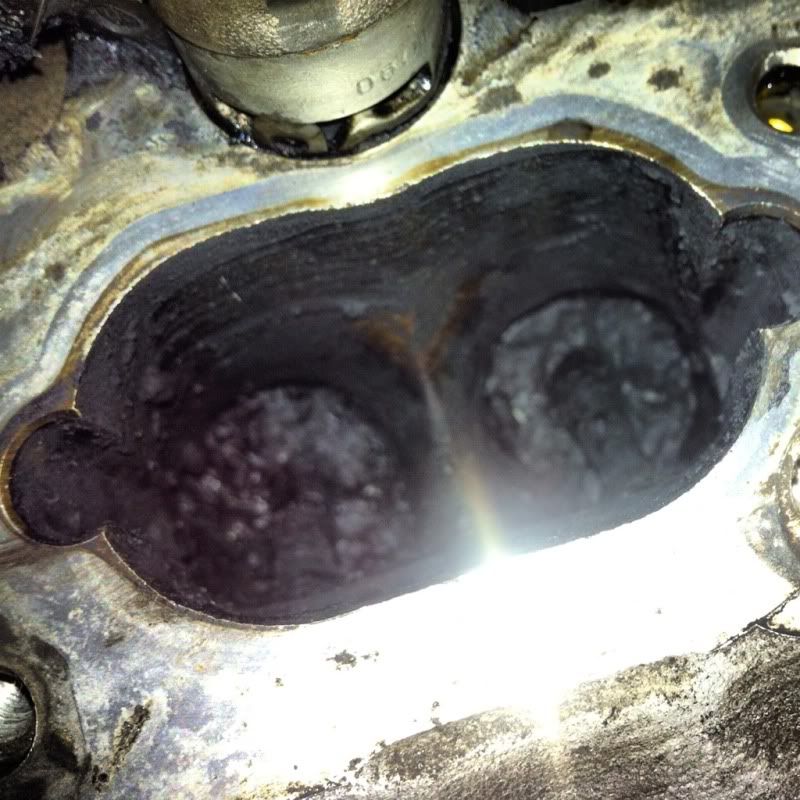

I think the two weeks is because they're having to be sent off once the engine's out (apparently book procedure is to remove engine to take heads off ?)
This is another pic I got ;
I can see why they couldn't do it in situ though as its a really awkward place to get into and it's rock solid
How AMD got those valves up that clean in their before/after pics that's floating around must be a work of a true craftsman or a serious amount of hours

That's my RS4 their website.

PaulRS4 wrote:That's my RS4 their website.
It's a work of art, how many hours was that ?

I don't know, they did say it was one of the worst they had seen though.
But it did make a big difference. Completely different beast.
Although I did have 100 cell cats and a remap at the same time

My car was done in situ, it was soaked in petrol and carb cleaner, like Pauls mine came up mint, the car was a lot more responsive with way more low down power, I think Audi are a bit behind when it comes to this, but if it's free fair play I guess

Forgot to mention mine was 5 hours work to clean

That's not that bad .. we do them with the engine in place ..
