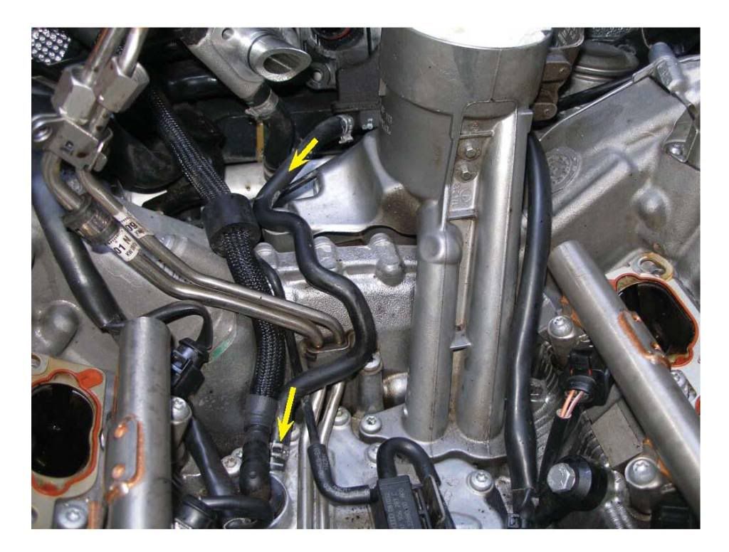

ArthurPE wrote:
the output line from the cyclone seperator to the intake manifold is disconnected and has a small filter on it?
or the lines from the valve covers are disconnected?
I don't think its either. There is no output "line" between the separator and the manifold - the separator is attached to and discharges directly into the manifold. The aluminum, tapered, silver outlet directly above the upper yellow arrow is the means of the discharge. The yellow lines indicate the drain line for the oil collected by the venturi to return to the sump. The breather pipes from the valve covers join together right before they enter the venturi. They are not attached to the air inlet ducting at all. There is a pipe clipped to the airbox which I believe just goes to the secondary injection pump (no reason for a filter there). There are also (2) small lines on the inlet duct immediately before the throttle body. Those also have nothing to do with the venturi or breather system. Without a picture of any particular hoses that are rerouted (if any) with the GruppeM its hard to say. If they put a filter anywhere on the breather system, it will be dripping oil like a '32 Ford.

silverRS4
- 2nd Gear
- Posts: 138
- Joined: Tue Nov 11, 2008 10:59 pm
- Location: S mode, USA
Post
by silverRS4 » Thu Apr 02, 2009 7:30 pm
Thanks. That is the line I thought you were talking about. However, if GruppeM calls it a crankcase breather, they are mistaken. That is simply the hose that supplies the secondary air injection pump. So rather than draw air from the stock airbox on the clean side of the air filter, the pump is now drawing ambient air that is filtered with the nifty little KN filter. That is perfectly acceptable. And contrary to my earlier post, the filter is a good idea since its now completely separated from filtered air from the airbox. Likewise, it shows no signs of oil because that hose/pipe has nothing to do with the crankcase ventilation system.

silverRS4
- 2nd Gear
- Posts: 138
Post
by silverRS4 » Thu Apr 02, 2009 8:14 pm
No, its not related at all. The secondary air injection and crankcase ventilation systems are separate systems. There was also some reference earlier in this thread to exhaust gas recirculation. That is not the case with the 4.2FSI. No hot exhaust gases are introduced (injected) into the cylinder heads - anywhere. I believe the valve overlap control offered by the ECU achieves the same purpose passively. To get this hijacked portion of the thread back on track (sorry Pippy!), the buildup on all FSI intake valves is due to the oil-separation system already designed into FSI engines being overwhelmed (or under-designed). That in itself is not a huge problem, but the fact that FSI engines have no cleaning effect offered by fuel being injected upstream of the valves means the intake valves suffer from build-up. Its really that simple.
