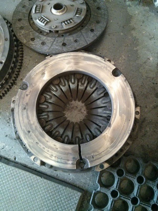

You will need to go for a performance clutch at some point its ok to say the OEM clutch will last if you don't launch it etc but you will want to. I am on my second now the first is below was meant to be good for 540bhp I think, now I am on the sintered one.
