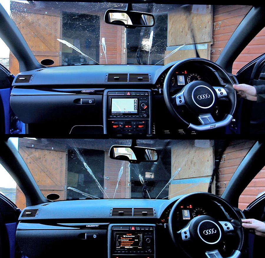

They are triple jets which when set correctly to factory placement look like a fan spray. Mine is a 07 facelift (albeit early one) and only has the twin jets, so perhaps they phased them in through the production run?
I shall fit the kit today and try do a before/after for you to see.

I went through 2 washer bottles just setting up the jet alignment. The rest is pretty straight forward and the only bit that had me stumped for a little bit was the plastic adaptors. I'll do a seperate write up with pictures tomorrow, but for now this is the difference.
