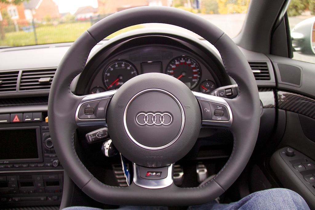

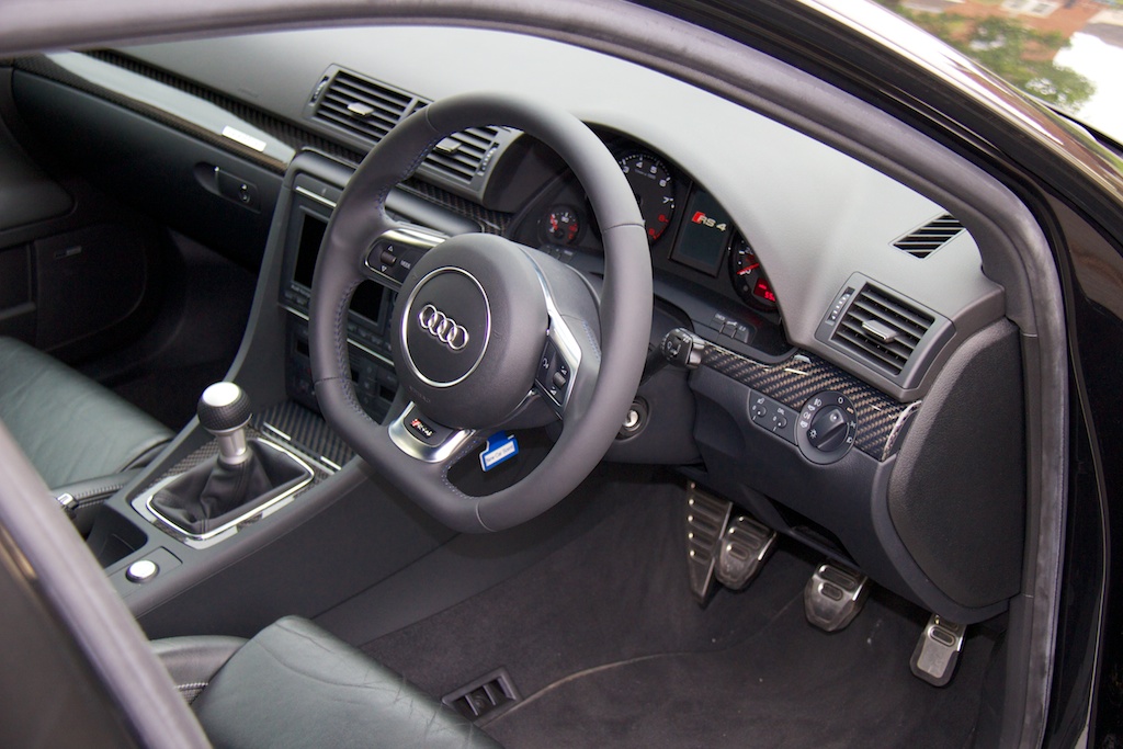

DO IT! It's one of the best mods I've done to my motor and really brings the interior up to date. I also fitted a 2010+ RNS-E and a Audi Music Interface in the glovebox. The RNS-E had custom FW which gave me full SDS including voice SATNAV control [IE enter postcode ETC] and I replaced the centre console to loose the mahoosive phone cradle .Mr Footlong wrote:I am contemplating having the TTRS MFSW wheel fitted, which will include relocating the Sport button to the dash and a new right stalk for all the menu functions
[attachment=0]IMG_2809.jpg[/attachment]
[attachment=1]IMG_2812.jpg[/attachment]
- Mr Footlong

Still thinking about it thanks. I take it that there are two different versions of the wheel? The one in this link is perforated - http://www.audi-sport.net/vb/retrofit/1 ... ofits.html
