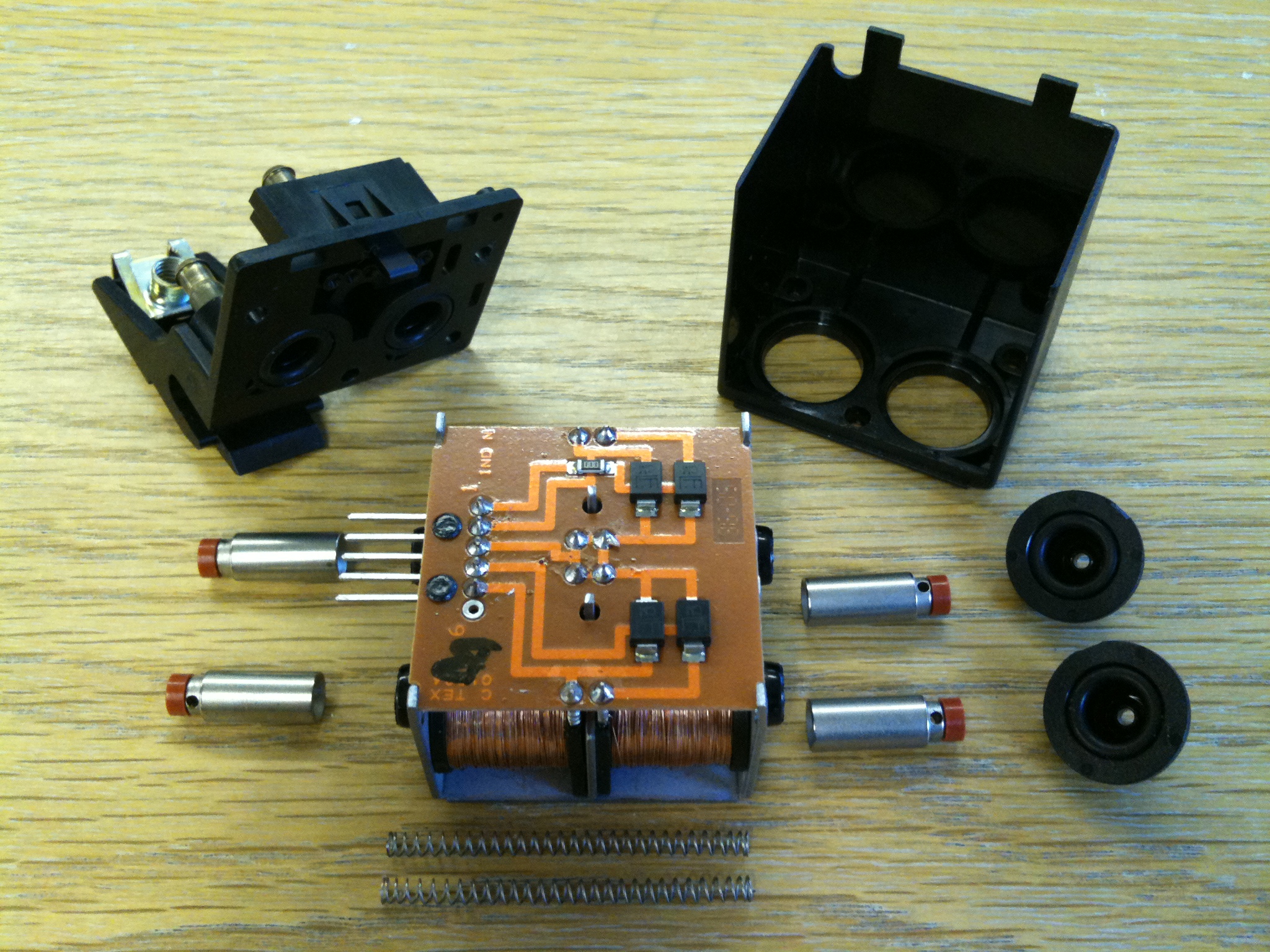

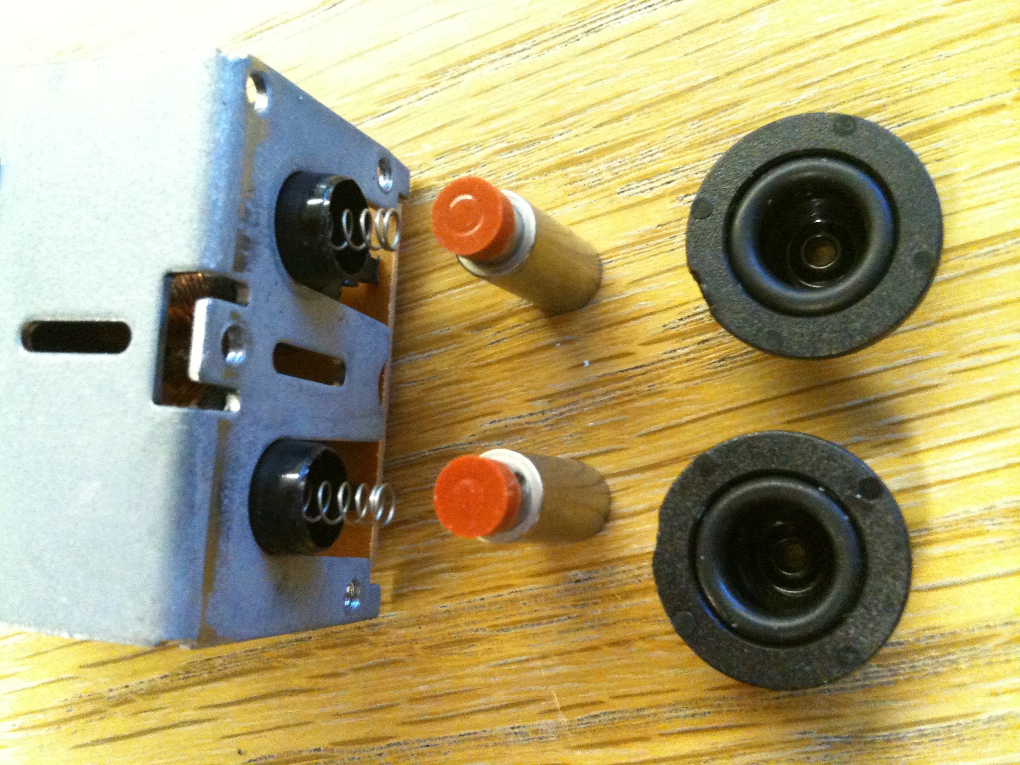

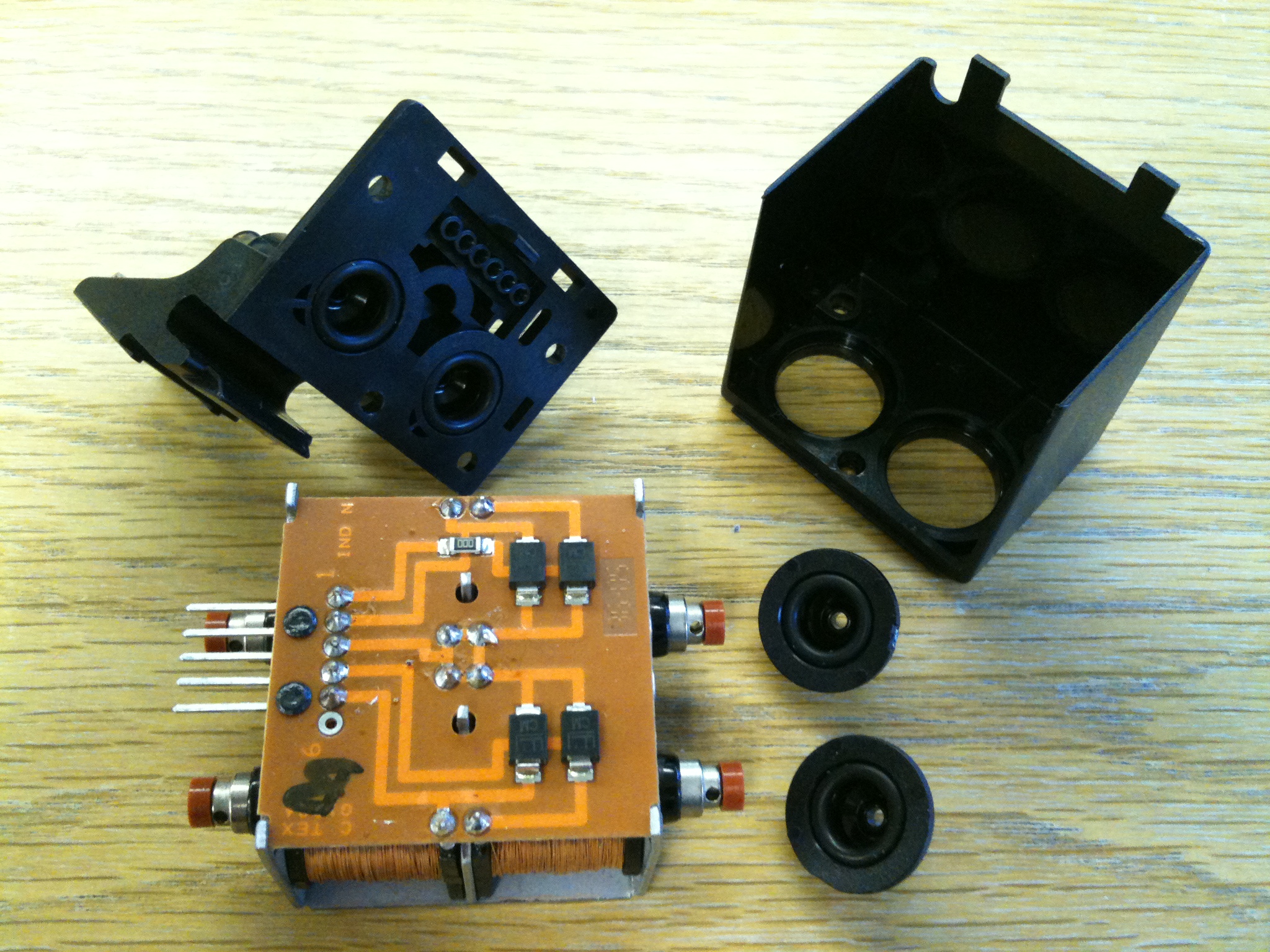

I don’t think there is a cheap fix to this problem. I did take the valve apart and had a proper look. There are actually 4 solenoid valves inside and not much DIY repair can be done. I do agree, it’s silly money for the parts and the cheapest I paid so far is £144.01 from Trade Parts Specialist, but I now know why Audi charge so much to repair these leaks. The parts are not easily accessible (bad design by Recaro) and because of it, Audi would replace all components (pump, pressure valve, 2x solenoid valves, air bags and numerous pipes) just in case.

Be interested in photos.. Also if you're going to bin the old one then be interested in having a look.
Re: Leaking Seat Valves
Here's some photos
