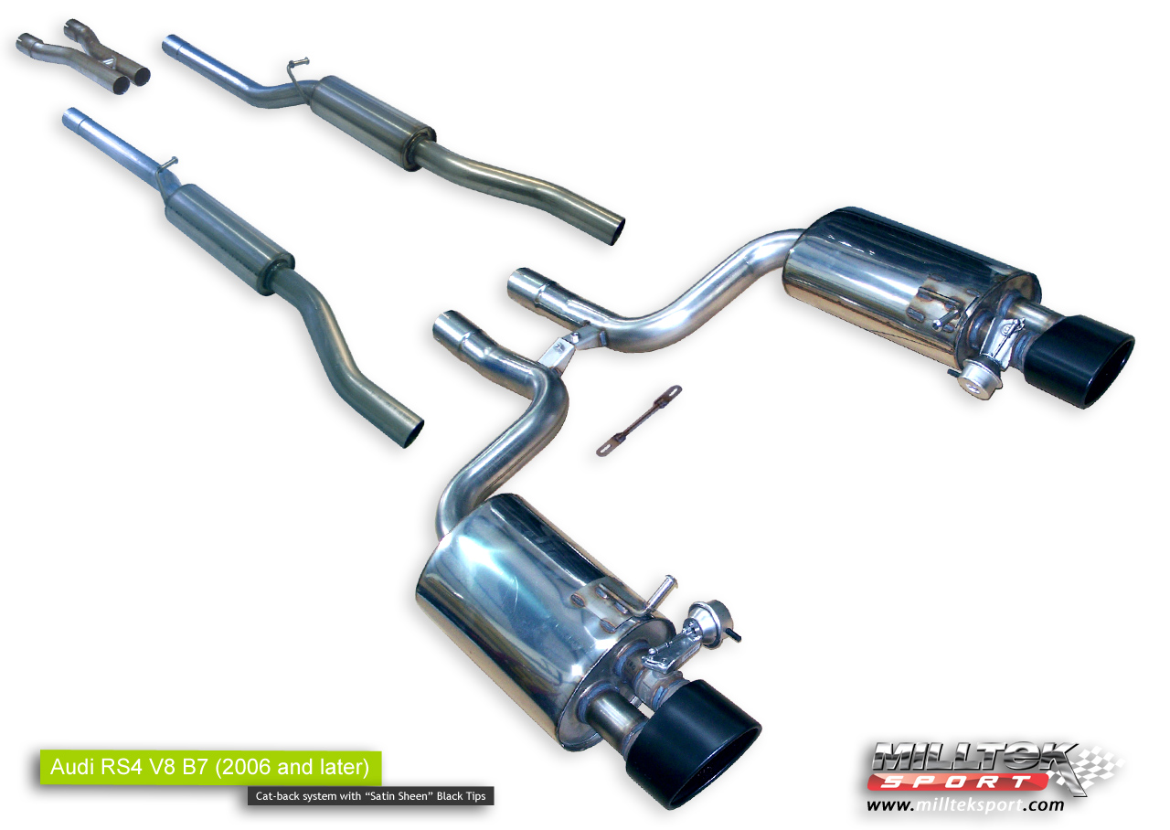

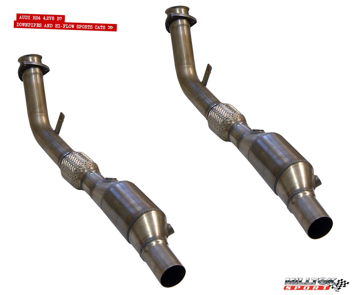

kay wrote:Thanks for that sonny. So there are only two parts to original exhaust....(i) down pipe with precats and main 400 cell cats followed by a (ii) backbox. Interesting. So, miltek options would include replacing the backbox with a resonated/non resonated valved/non valved backbox ; also replacing the d/p with the pre cats and main cats with a free flowing d/p (without precats) with option of a 100 cell or 200 cell main cat. Somebody please confirm my understanding.
Milltek downpipe would include the cats, followed by a small link pipe, then either res / non res pipe, followed by back section.
So if I'm right (and replacing all pipework except manifold) - the original two piece (each side) is replaced in total by four sections of milltek (each side)??
Hope this helps. If I'm wrong, someone will be sure to correct me.
sonny
Posts: 10278
Post by sonny » Wed Jan 20, 2010 10:05 am

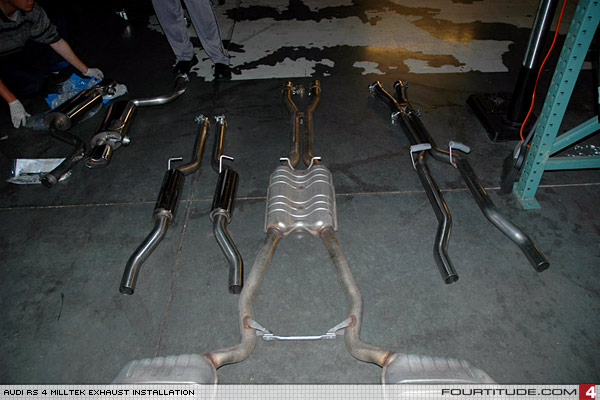

First pic. OEM cat back in middle with Res and a non-res sytem either side.
Second pic: Miltek cat back system (6 pieces, inlcuding bracket).
Last pic, Miltek Cat and Dowpipe, one piece.
