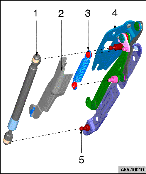

Factory fit on mine:
Two struts, same, 8E5 827 552 K01S
Plus i see a spring about half inch diameter, 8 inches long between boot lid and body on each side parallel to the hinge under a plastic cover.

Here are what the struts should look like.

Boot hinges part number (from ETKA not inspection):
Auto opening: 8E5 827 301D (or H for later models) - LEFT HAND SIDE, RHS is 302D/H
Non-auto-opening: 8E5 827 301C (or G for later models) - LHS, RHS 302C/G
My EKTA is a bit old, so may not be latest numbers. However, point is they're obviously different.
