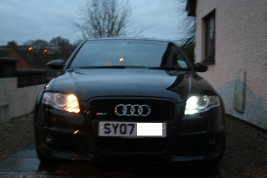

Finally got round tp posting the pics of the LEDs as per rjkflyers instructions. Great advice. Cheers. No faults found by car. A wee bit fiddly doing the soldering on the drivers side lamps but nothing too bad.
Pics show both types of lamp, mucky filaments left, new LEDs on the right.

V. nice. The LED's look waaay better!

Great job! Actually really good to see the X:Y comparison - had forgotten the relative improvement!

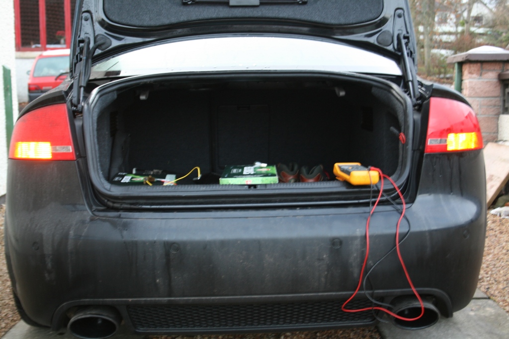

Its the same type of bulb from the drls that goes in the rear cluster for indicators etc. Tried it very quickly as it was getting dark tonight. Looks pretty cool but not so easy to do the resistors. Gonna take the lining away from the boot tomorrow to see if there's enough space. Very difficult to show the effect properly but the LED binary on-off rather than dimming and lighting as per the filaments looks much better (just like my old m3!). LED lamp is in the cluster on the right shown below.

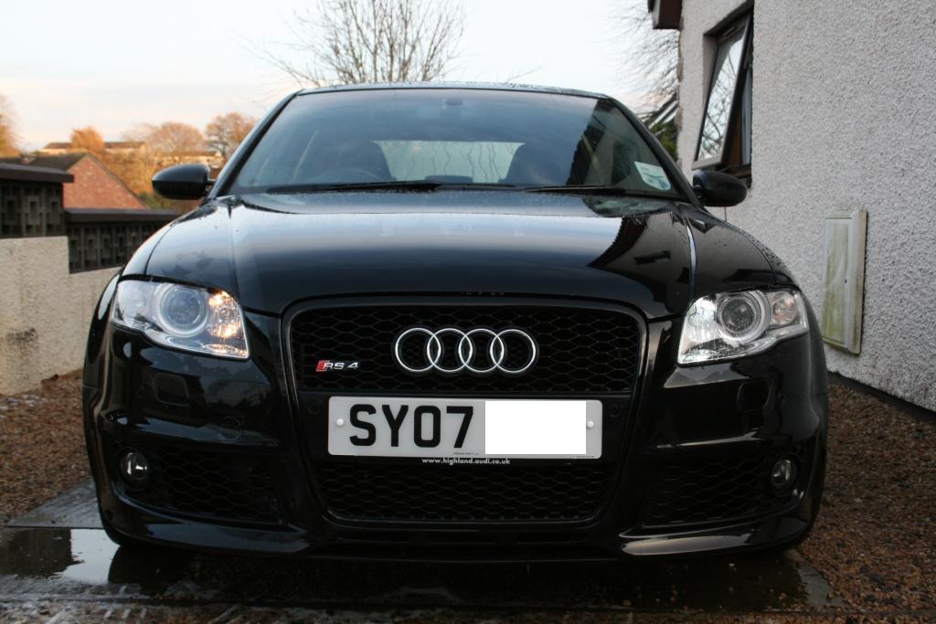

And, before anyone asks, yes it is the same car! just the front is nice and clean for the first pics!!
Just for reference, also a pic of the front in the twilight.
