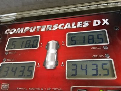

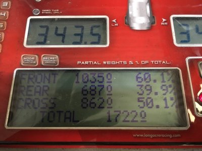

My car is focused to shift weight forward and corner weighted with my weight in the drivers seat and weights in the boot to represent a full tank of fuel. After tuning my car felt more focused and confident, turned in more sharply and handled at speed through bends better by a vast margin. Going round and round a roundabout showed the understeer had gone. On a bumpy road it felt more stable too.

Did you get the print out of the numbers from CoG Cov? Be interested to compare.

Post by Covkiller » Fri Jan 11, 2019 11:08 pm
Yes, I'll have to scan and post them, may not be until Sunday though as off to the Autosport International show at the NEC all day tomorrow, can't bliddy wait.

Post by Covkiller » Sun Jan 13, 2019 6:01 pm

Thanks for posting. Might want to blank out the vin though. What are the corner weight measurements?
