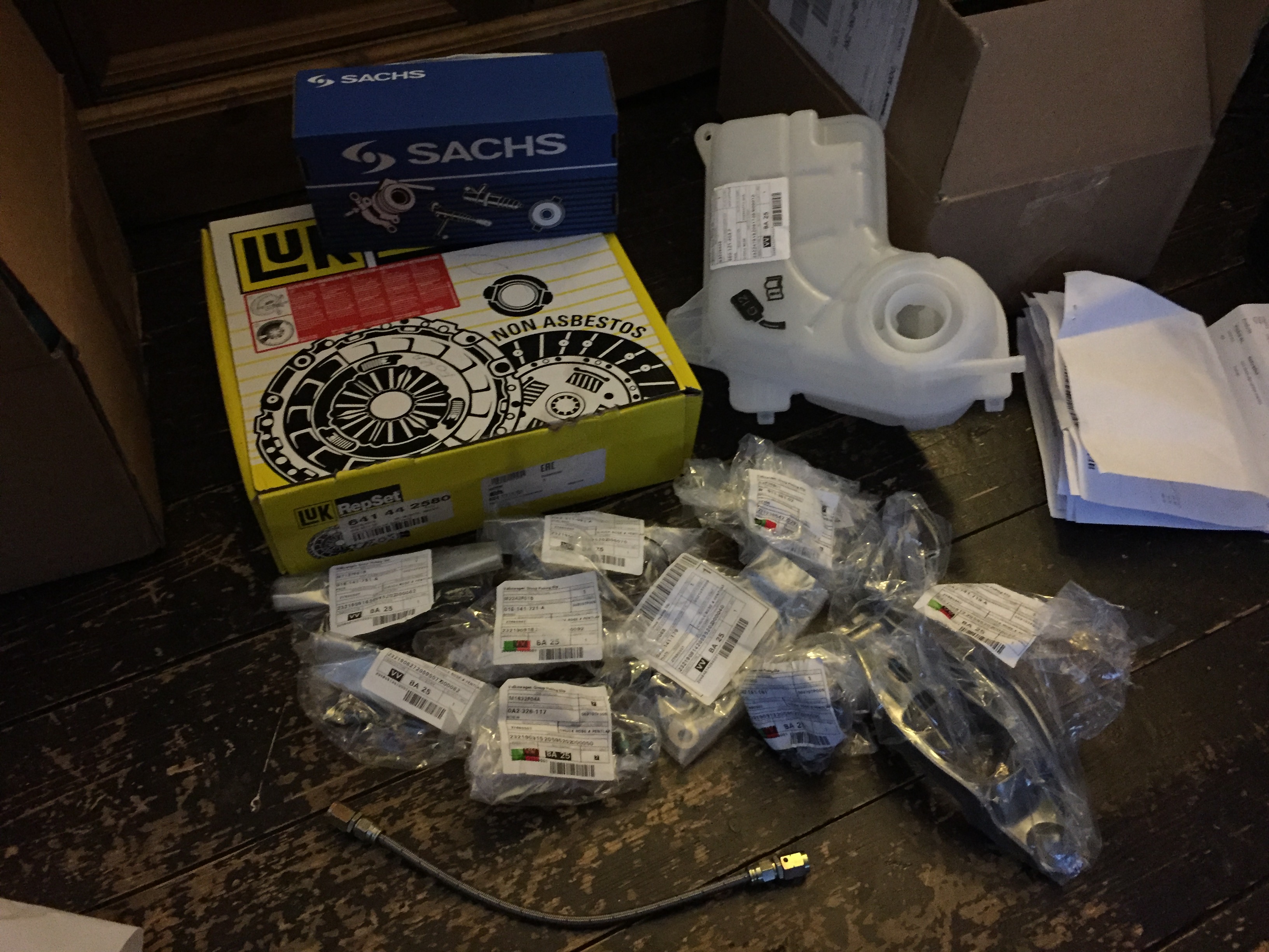

Tackling the clutch change on Saturday morning. Anyone that's previously changed it am I looking at a Saturday/Sunday job? Also is there any hidden bolts? I know on some vehicles you can have bolts going through the opposite way. Got the clutch, plate, slave, stainless modded pipe (cheers rob), release bearing and all internal clutch parts in the gearbox for a nice £288 :thumbs:

Haha, do that without fail now, been caught out on that before. Does anyone happen to have the torque specs for pressure plate and the retaining bolts for the fork etc? Also is the slave bled normally or reverse bled? Into work for 7 tomorrow to hopefully get it blitzed. Nice selection of goodies below.

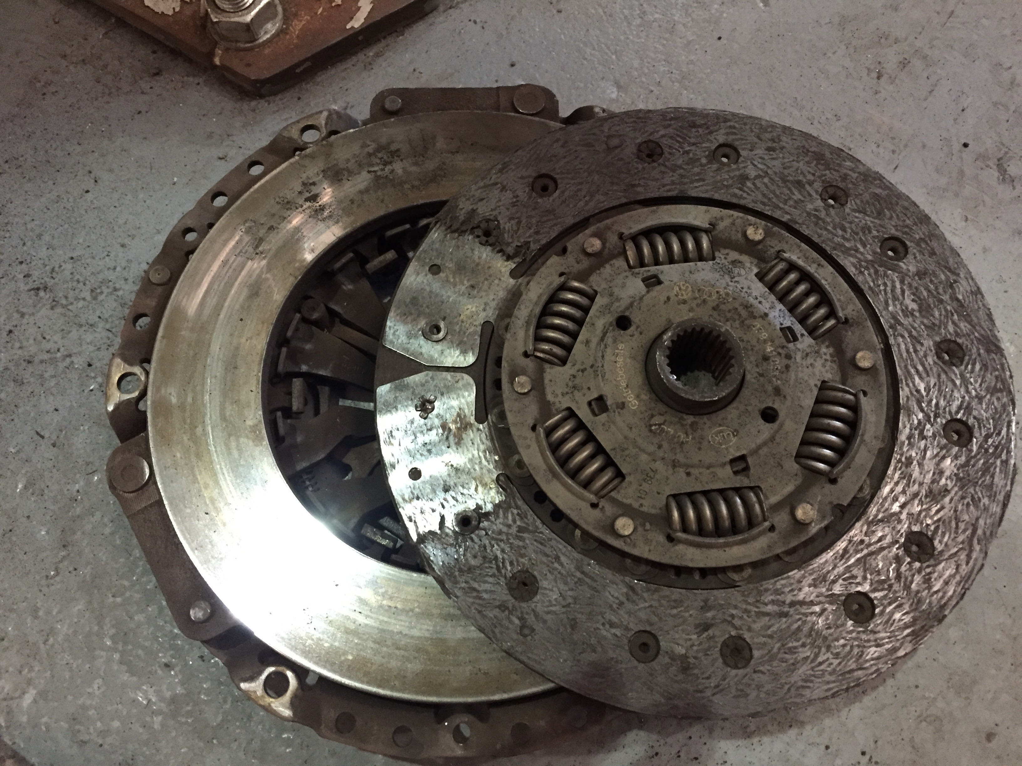

Post by chuckrs4 » Sat Oct 08, 2016 6:17 pm
All done. Safe to say it was truely worn :shock:

chuckrs4 wrote:All done. Safe to say it was truely worn :shock:
sweet, how much work/time?
