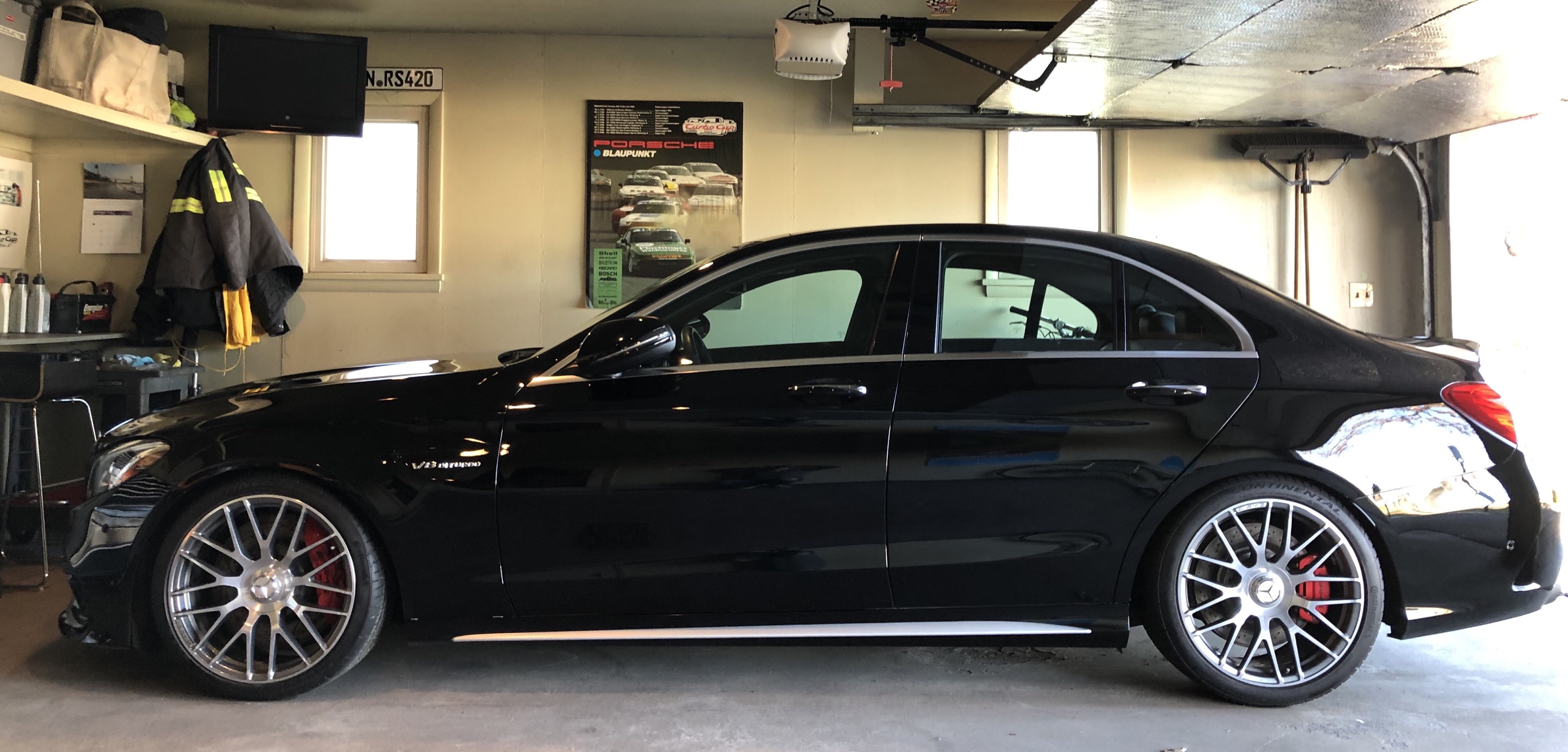

I went crazy and lowered it
Eibach pro-kit
Spec F/R 0.8"/0.4", actual 0.8"/0.6"
Spacers 10 mm/12 mm
Actually rides better, very surprising, quiter/less harsh
Height difference between 0 fuel and full is greater than oem meaning spring rate is lower/softer
Firms up as it takes a set in a corner
oem was prettt stiff
It was the first thing my wife noticed: she complained in previous cars when lowered
