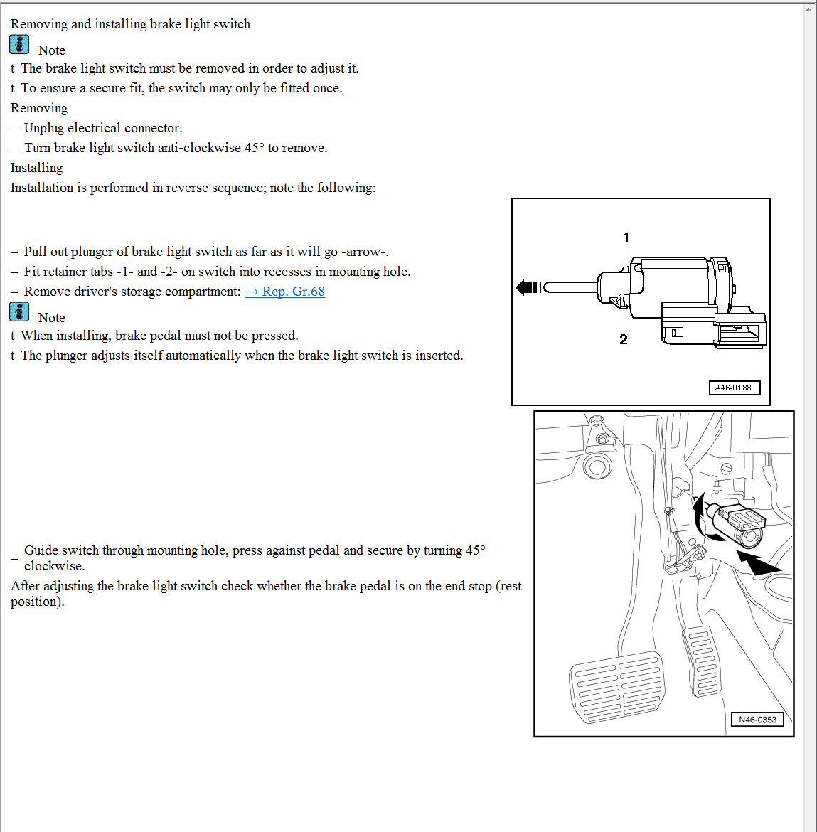

Here's one for the Brake Light Switch :thumbs: Again, I've not replaced this item so have no experience on it to share.
click to enlarge
ELSA - Brake Light Switch renewal

Cheers Sam and Audi_do_dat_den for all the pointers... .Mission accomplished and brake lights are now again operational!
Appreciate all the help and pointers along the way... took all of 10 mins in the end... Was just worried I was pulling out the wrong switch :biggrin2:

Cool, did replacing the BL switch sort out the ESP light/problem you had?

Surrey Sam wrote:Cool, did replacing the BL switch sort out the ESP light/problem you had?
Yes Sam, no more solid ESP light after changing brake switch.... Happy Days!
