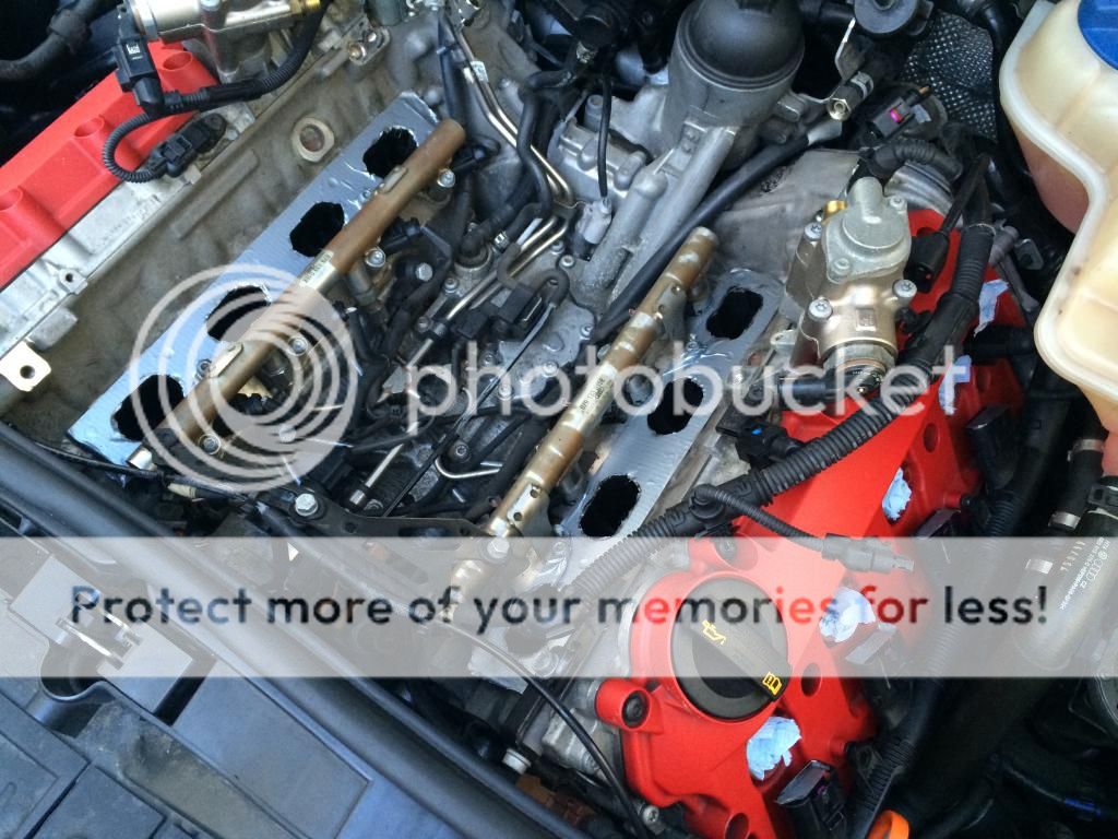

Head port mating faces protected, cleaned cam covers and filter housing:

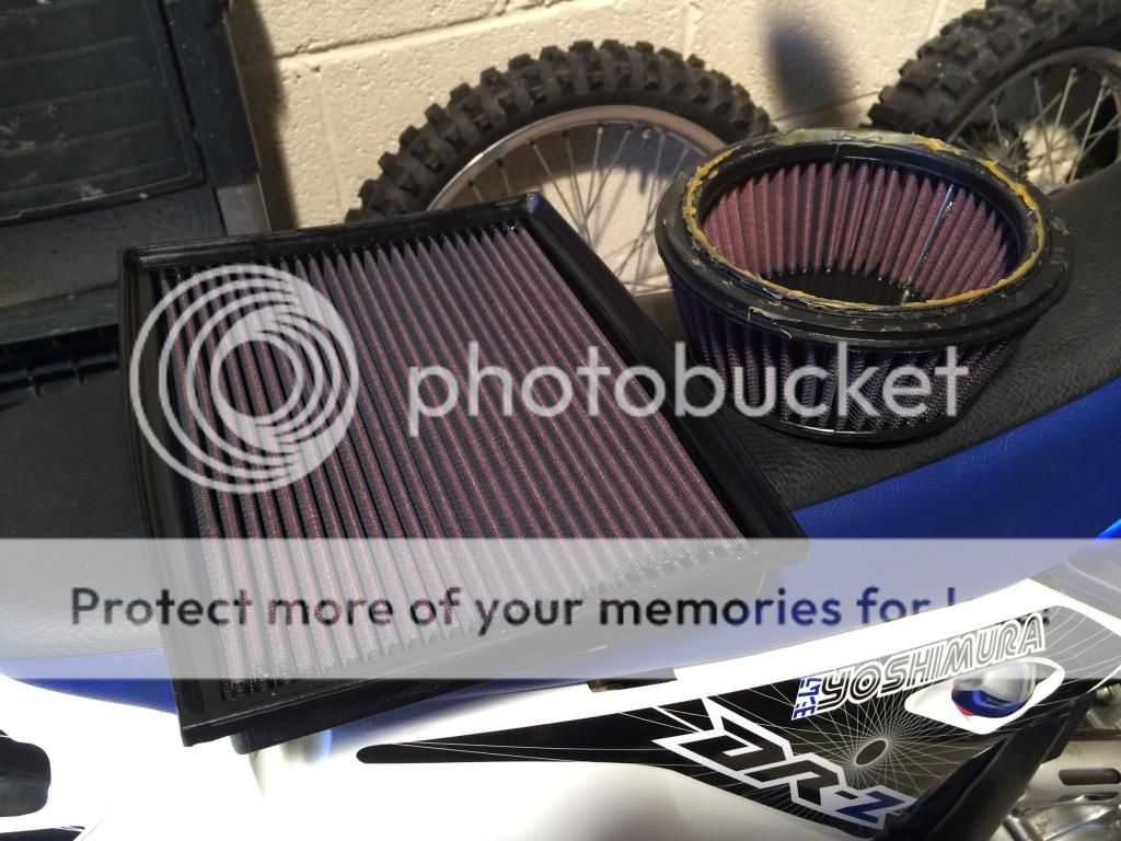

Cleaned and re-oiled panel filter (did my bike at the same time as the cleaner was out):

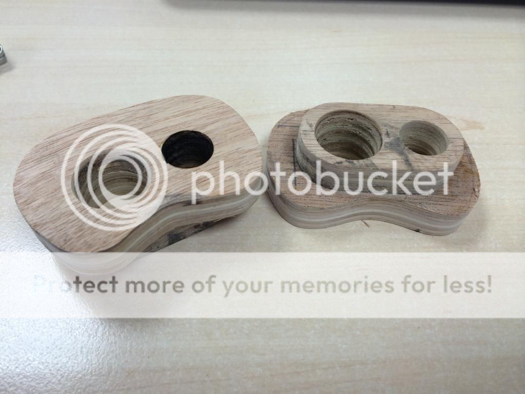

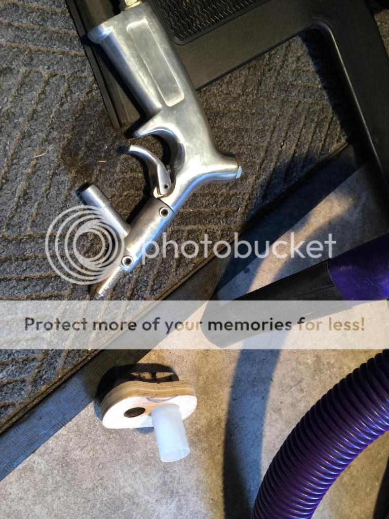

Fabricated and put together parts for walnut blasting/removal:

Careful with the oiled filter you will kill your MAF pretty quickly

How come?Rick_RS4 wrote:Careful with the oiled filter you will kill your MAF pretty quickly

Think rick means that if you over oil the filter the excess oil clings to and ruins the maf/air flow sensor, it looks a lot in the pic but it's bare minimum oil coverage to turn cotton from white to red

Re the oil on the filter they gave been known to kill the maf s even a small amount. That's why revolution moved from oiled pipercross to a 2 stage dry filter. There's a thread about it.
