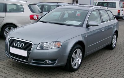

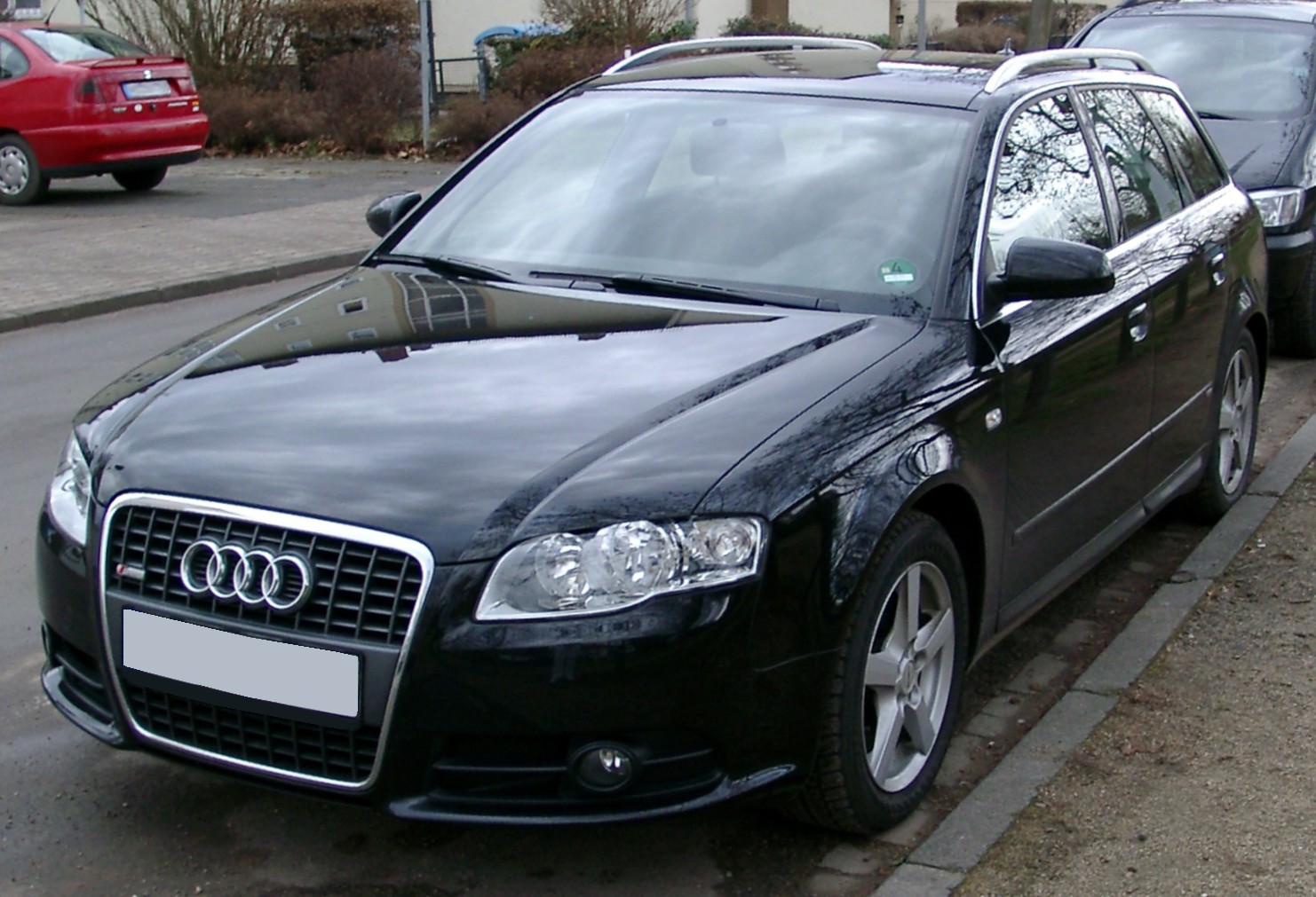

Yes. The A4 S-Line, S4 and RS4 grills are deeper. I have made a full honeycomb grill (like the C6 RS6) for my car and to keep the cost down, I used an A4 S-Line grill. The normal A4 grill would have been even cheaper, but it is smaller than the RS4 grill.
S-Line A4
Normal A4

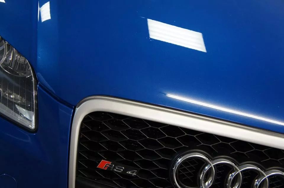

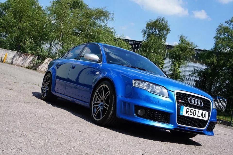

Update lads
Car has been with midlands car care for a week had a detail,wheel refurb an sorted the grill out.
See what you guys think.

Post by Youngben » Sun May 18, 2014 10:52 pm
Russ is spot on. He did mine around 12 months ago. Been following this on Facebook and noticed it was yours from the grill. Nice job.
Matt_lad
Posts: 91
Joined: Tue Mar 18, 2014 10:42 pm
Re: Bubbling grill.
Post by Matt_lad » Mon May 19, 2014 12:10 pm
Great job there, grill looks good as new. You must be very pleased. :thumb:

I think i remember following yours been done ben around that time,ross seems fine, to be honest i have been booked in for a while an waiting but he was telling me how busy he is.
Happy with the how th grill looks now better then that bubbling crap an no where near audi price for a new one.
There are a few marks still but they need sorting by paint ect,
Cheers for the comments lads the 4 is starting to look loved lol.
