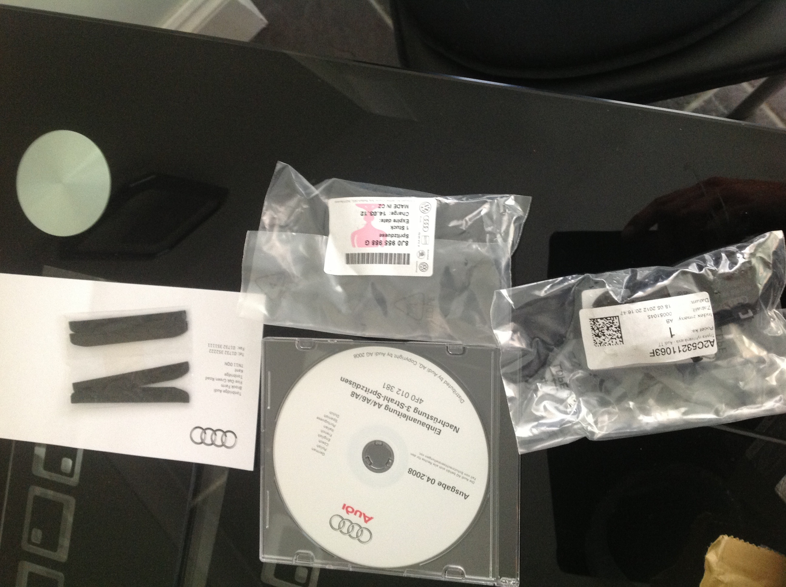

Post by Batfinnk » Wed Aug 14, 2013 4:29 pm
My kit arrived today and here is what you get. All fitted and took about 5 mins. The biggest pita was adjusting the jets to aim where you want them. Did read the cd but ignored it adjustment wise. All worked out ok in the end :kissmyrings:
Definately a good find by the op. :beerchug:
