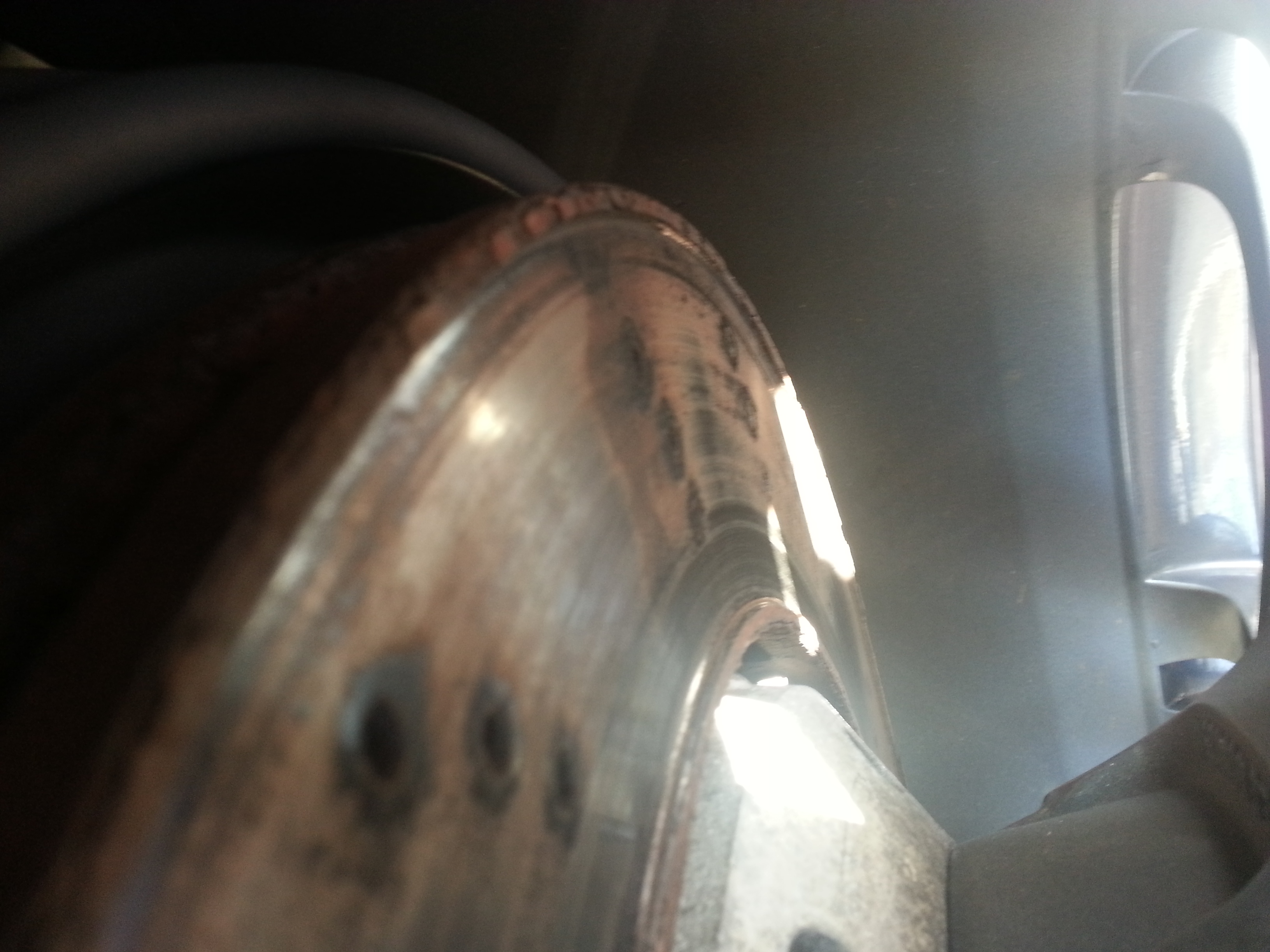

Here are some photos of the discs, not the best but you can see the giant lip on them. Now maybe I am to blame for not noticing this and getting caught in the moment of seeing and buying the car, but every mechanic who has seen and felt the discs says the car should never have been sold with these on in the first place.

they don't look good mate.
so basically the dealer sold you a car with knackered brakes, knackered front suspension and dodgy headlights....nice!.
unless the dealer agrees to do all the work without fuss i would return the car and demand your money back.
that is 3k+ to spend there just to make this car safe.

Yeah I feel like a bit of a mug.sar wrote:they don't look good mate.
I'm in talks with him about it all now, hopefully he does the right thing.
