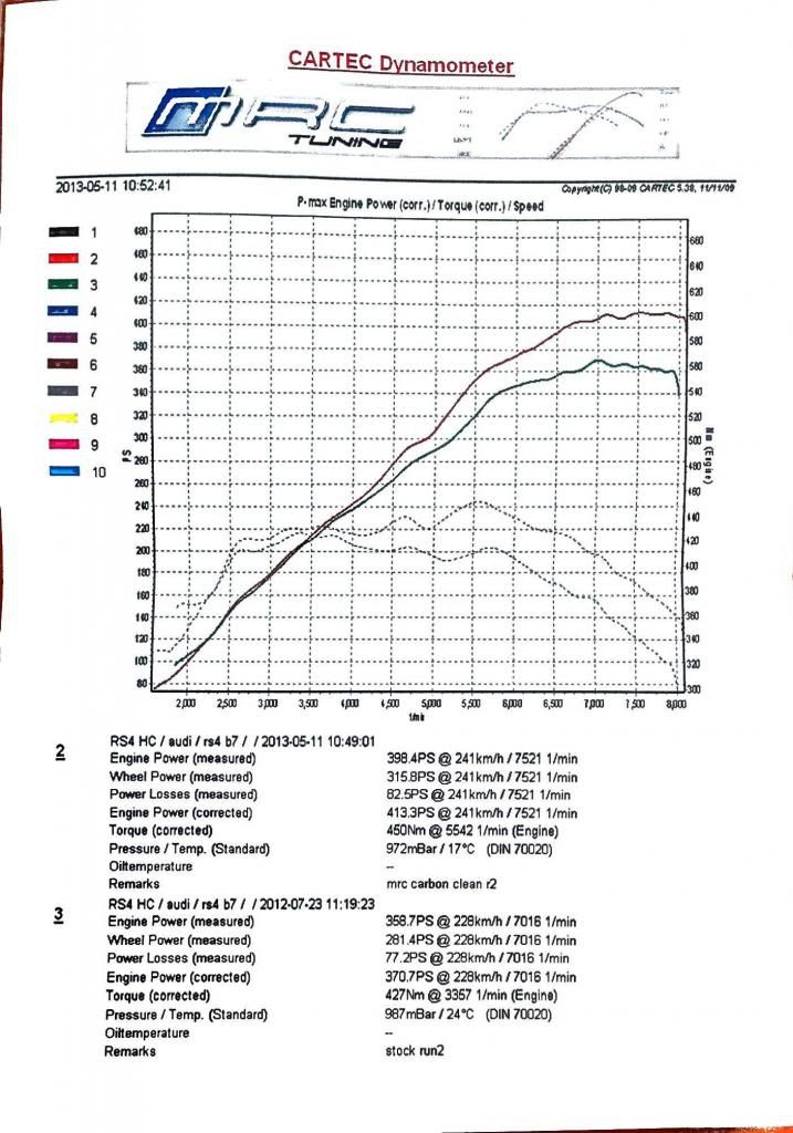

Picked mine up today after MRC Carbon Clean (cost £900) and now measured at 413PS and 450Nm. Previously had it dynoed by MRC back in July when it came in at 370PS & 427Nm. See plots below.
Therefore uplifts of approx 10% power (43PS), and 5% (23Nm) torque, giving a cost per horse of £21. No other engine/exhaust etc work has been done, so increase all attributable to the clean.
What does the difference feel like? Well it's really hard to stop the psychological stuff coming into play. Yes, immediately it feels faster in terms of acceleration. But then again over the last two days I've been driving a courtesy car in the form of lowly Chevy Kalos. So the mind starts playing tricks and initially I think the gear change is smoother and handling maybe a little better. It's such a weirdly subjective thing, but overall I'm happy.
Anyways that's my experience, your mileage may vary.
Re: Carbon clean, Before and after power output?
Some of that may also be attributable to the change in temperatures between May and July. The temp shown on the plot was 7 degrees higher on your previous run.
