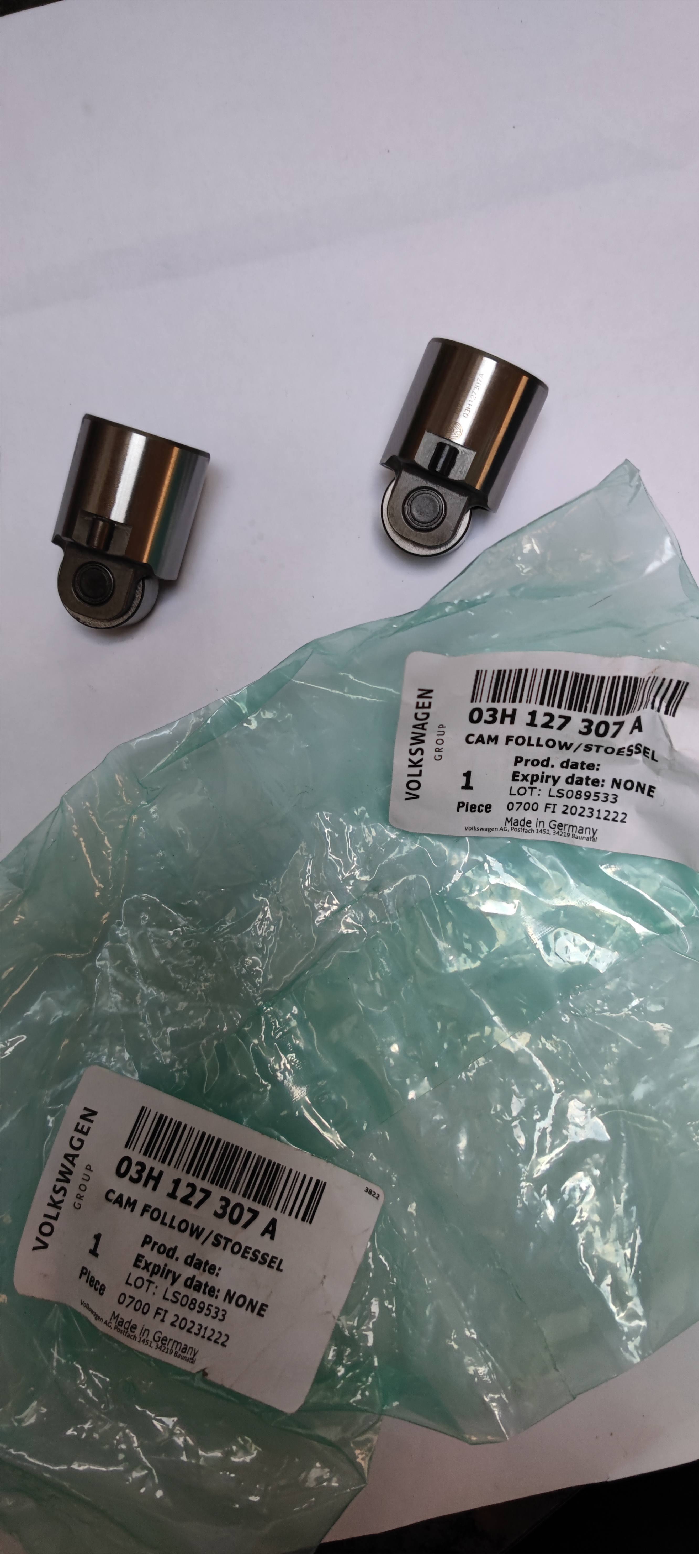

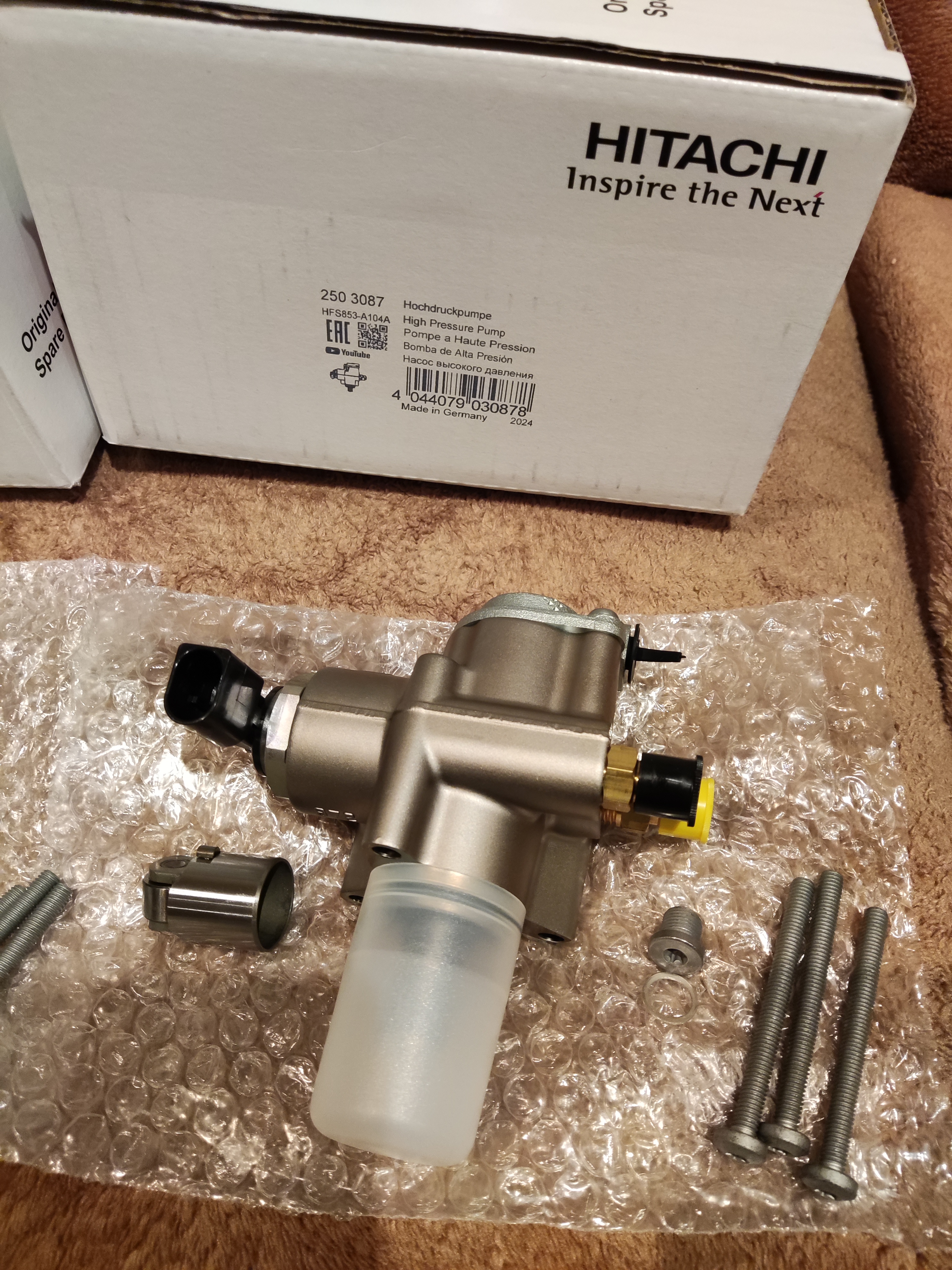

ok - so the HPFP parts have arrived:
Re: Fuel Trims, MAF, VCDS, Data-logging, CSE Mathematics + Reading GRAPHS!
Parts Ordered:
2x OE Hitachi HPFPs
2x OE Cam Follower / Tappets
6x Hex Bolts
2x Seal plugs / bolts
2x Washer rings

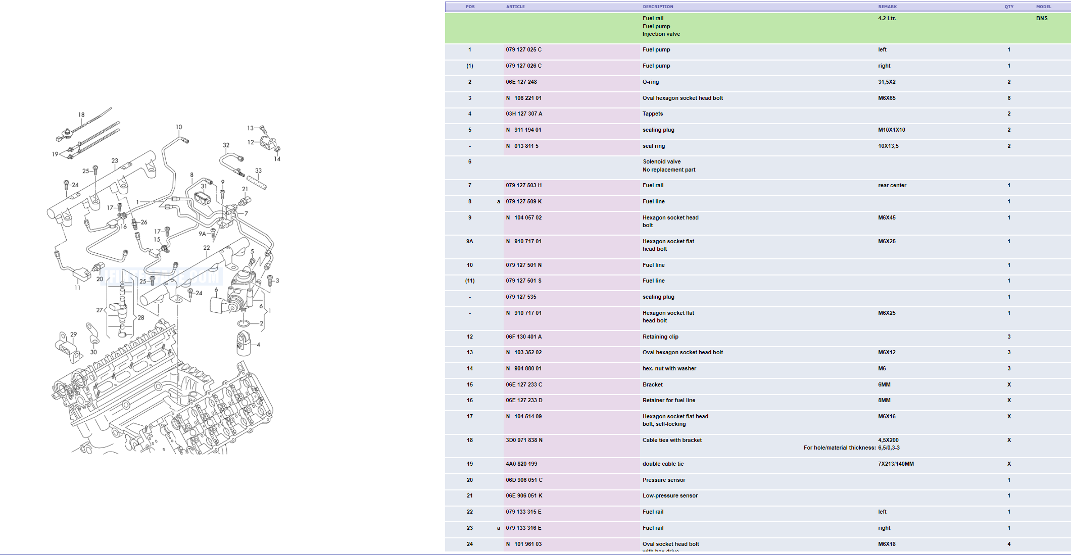

The part numbers are listed in the diagram below, for your benefit:
2x OE Hitachi HPFPs
6x Hex Bolts
2x Washer rings

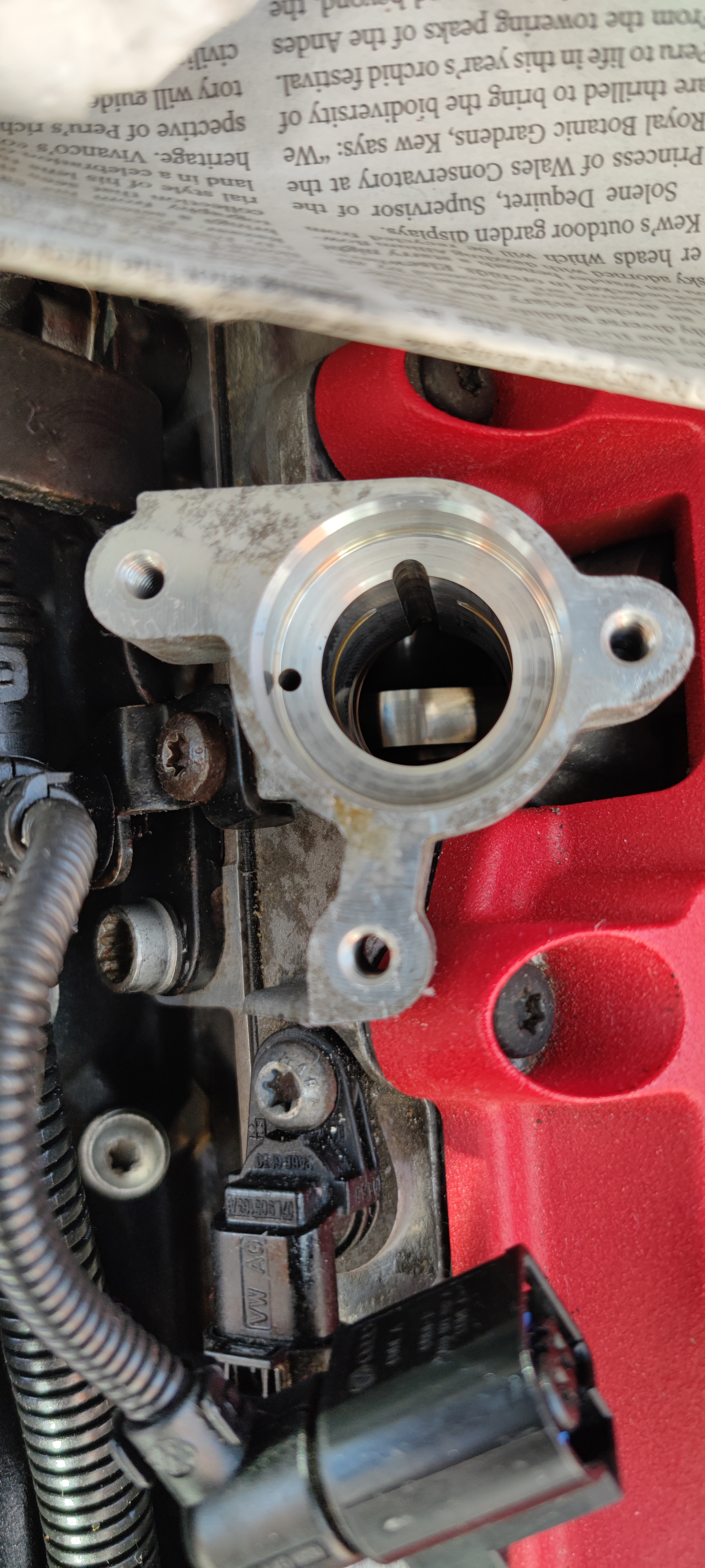

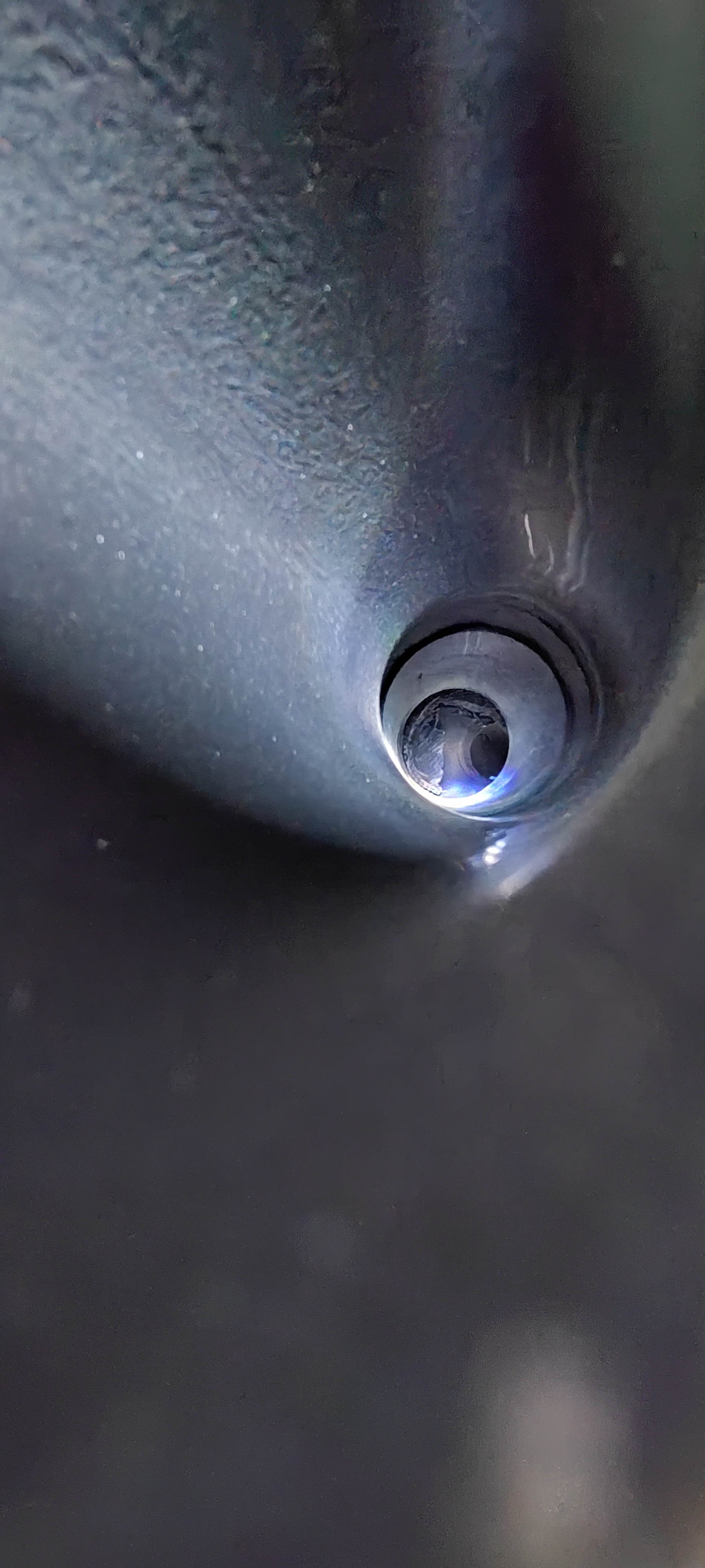

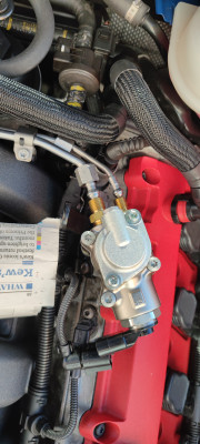

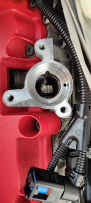

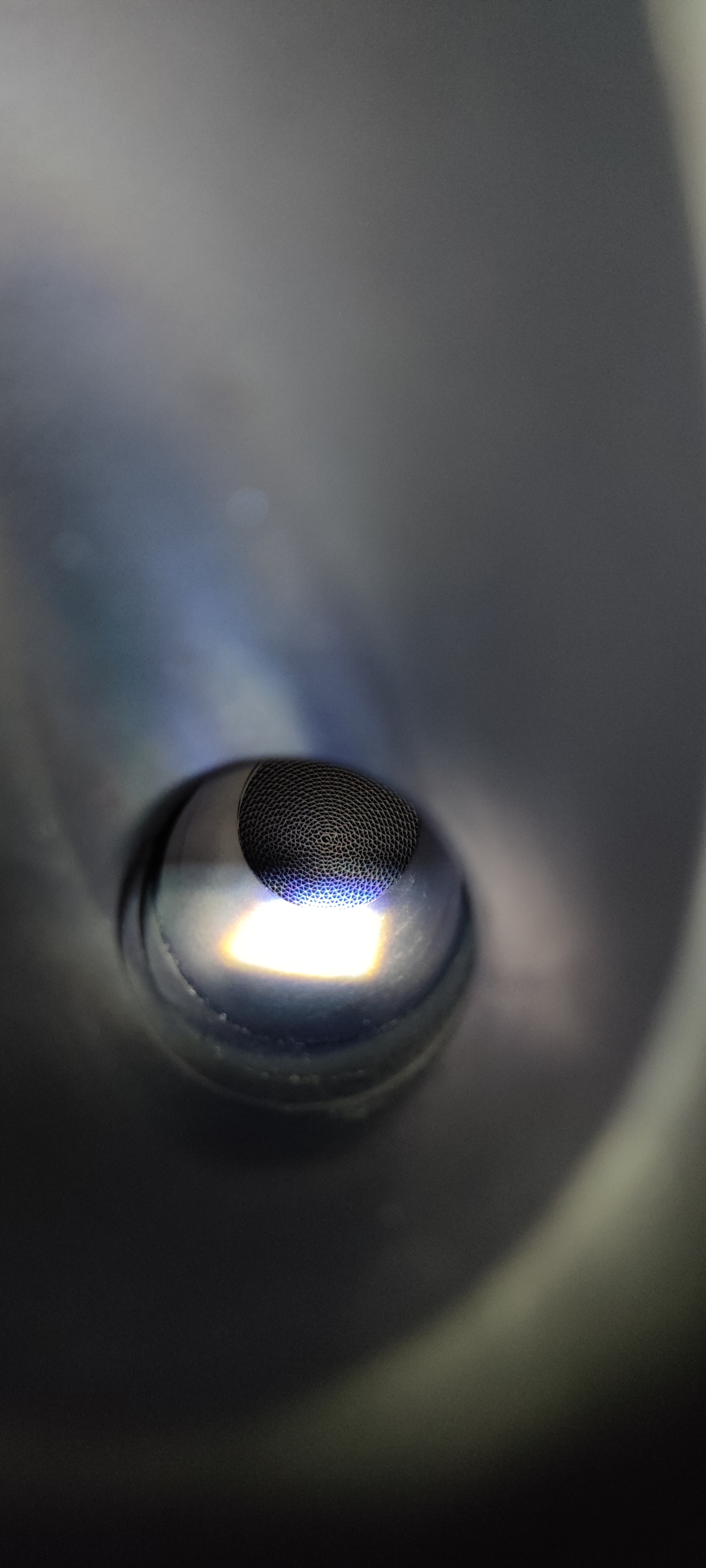

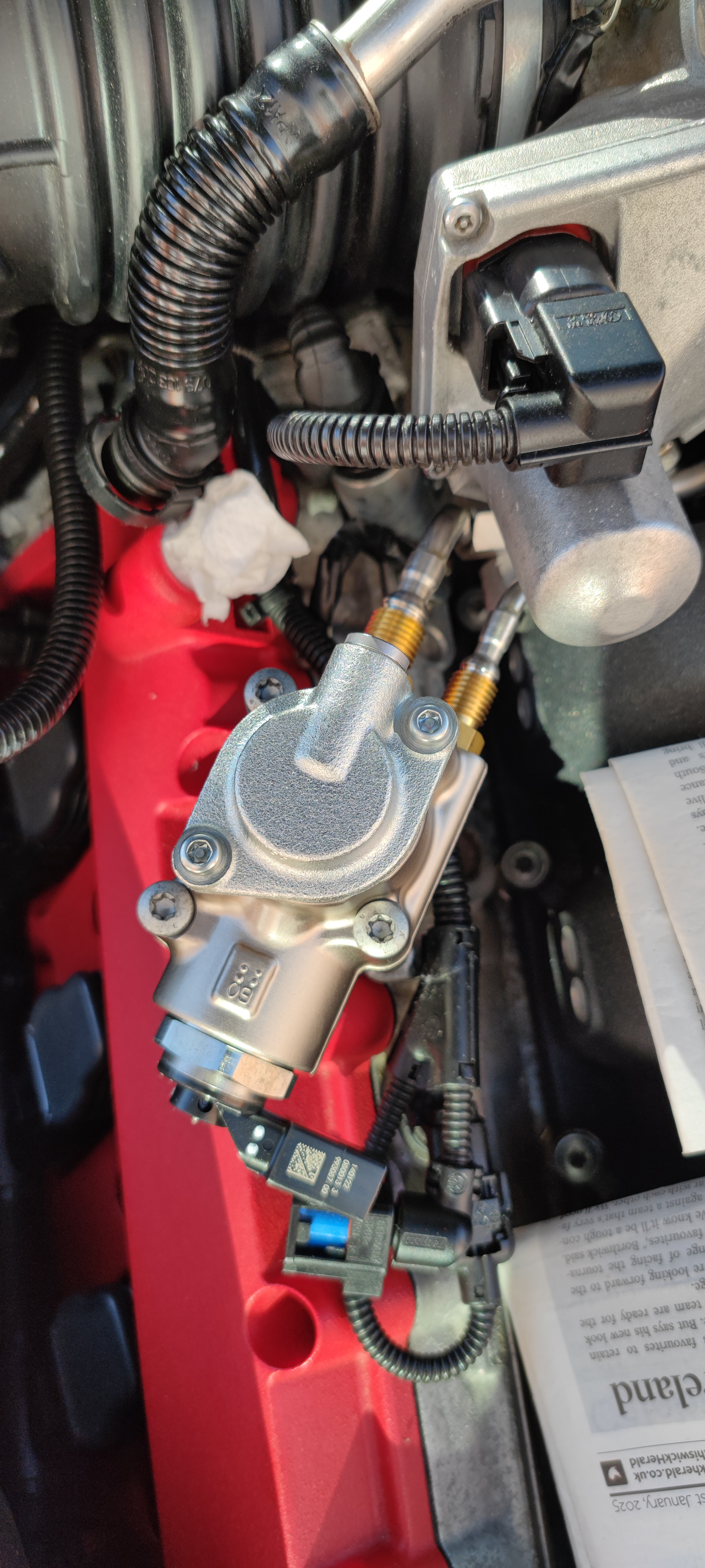

So, after switching over the lambda connectors.. and few runs etc the RS was running much better , albeit still wasn't running quite right..
Next up, proceeded with HPFPs + cam followers installation:

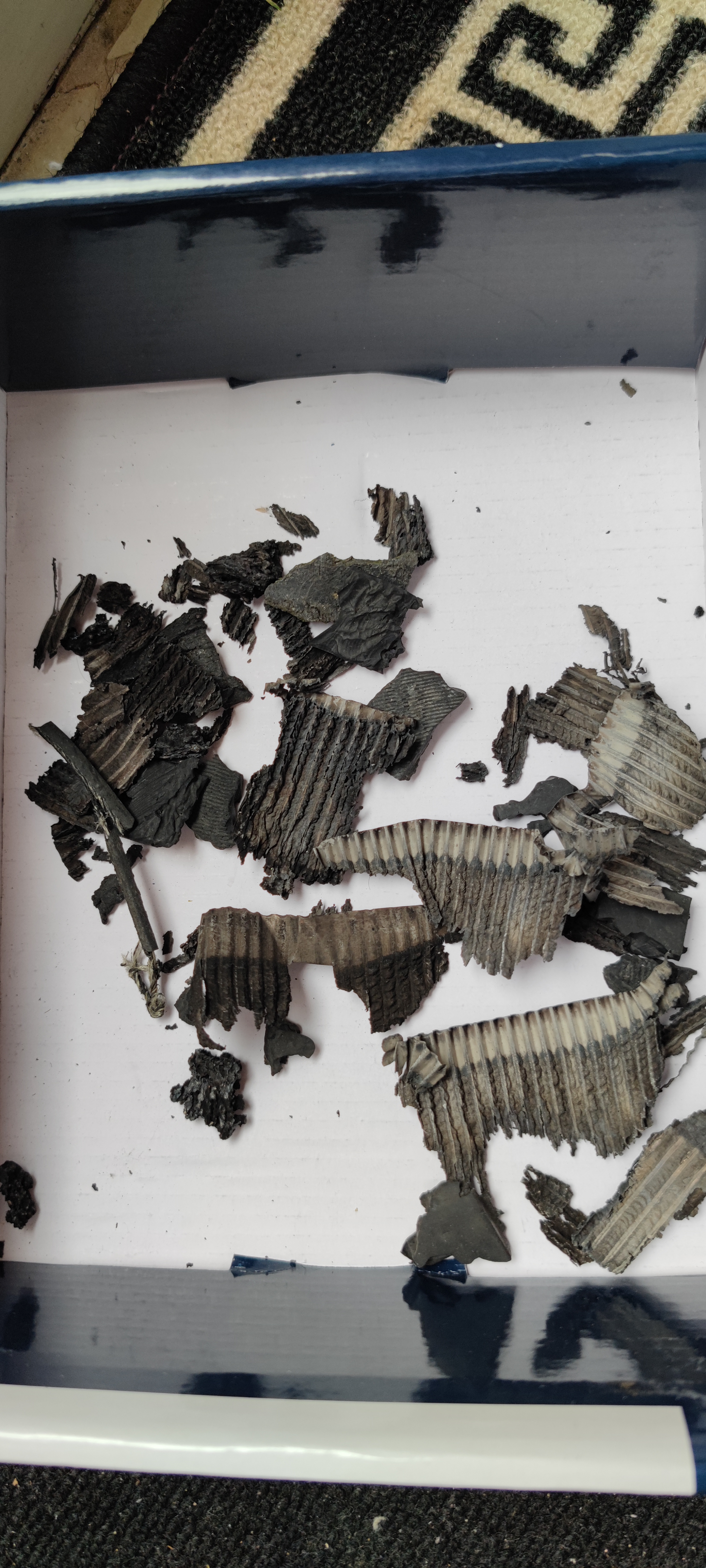

hhmm. Was rather disappointed with that, albeit stock - at least it now wasn't pulling timing at WOT!
BUT.
That was the least of my disappointment. During the run, I was outside and noticed, to my utter amazement, loads of bits of
was flying out of the exhaust tips!
I showed Doug the mess on the floor outside after the run and he straight away (rather casually) said "your CATs have disintegrated!"
I was like, what? they're literally brand new Zinram 200 cells sports cats, highly recommended on the forums etc, German made!
He swiftly replied "I think you'll find the CATs are likely from China, not Germany!"

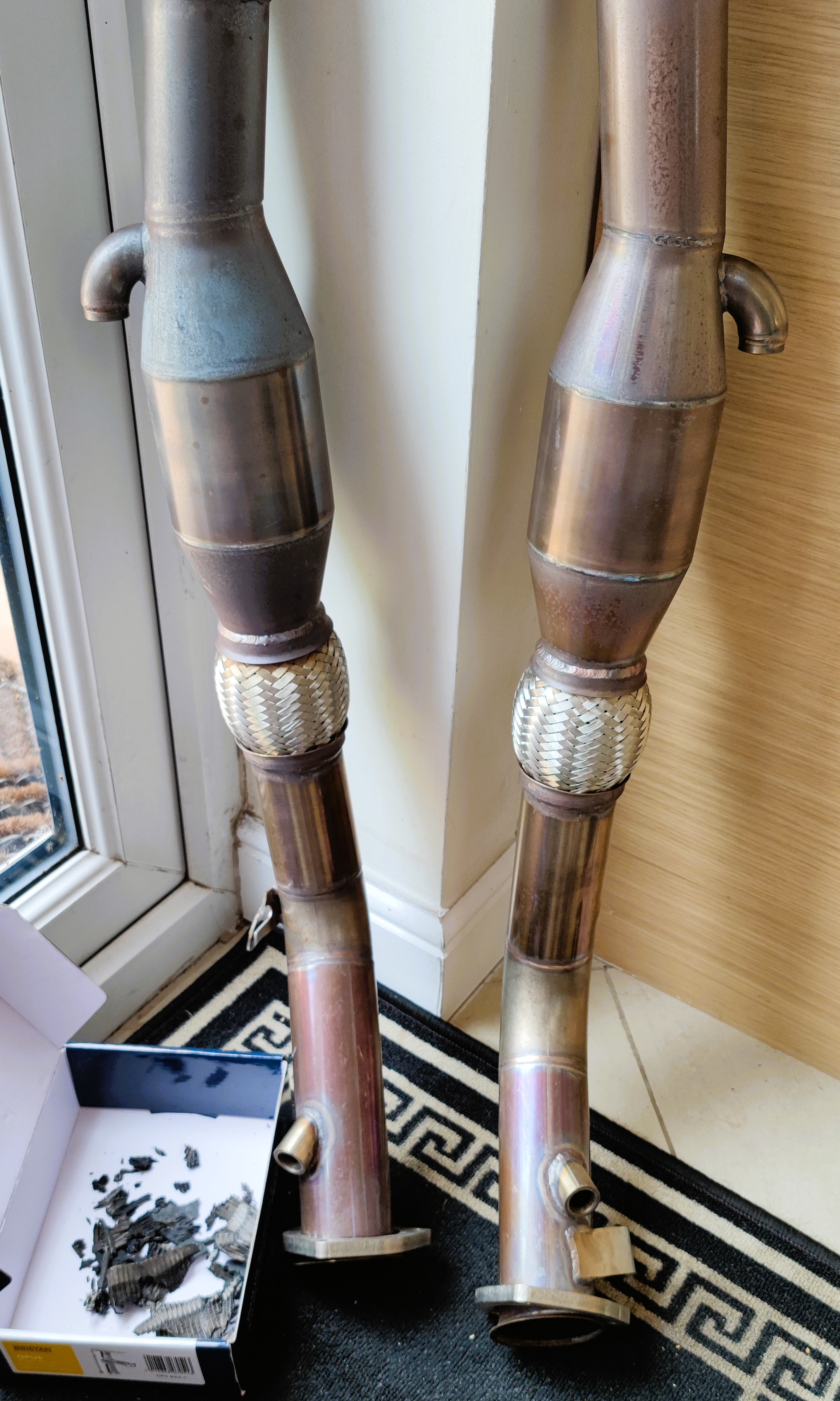

Can't even make this up.
Some unknown <beep> ECU tune and the kicker, Zinram Sports CATs that had been clogged up / falling apart, causing issues, literally soon after installation.
After picking up the pieces of my disintegrated CAT (don't laugh) I had a chat with Doug.
No point proceeding with the MRC Stage 2 Tune, with these <beep>, (not made in Germany) falling apart downpipes..
I had to bite the bullet and went with Milltek downpipes Sports CATs , which MRC carry in stock.
The Milltek Sports CATs cost a fair bit more, but at least would bolt straight onto the existing Milltek CAT-back valved & Non-Resonated Cat-Back Exhaust System without drama.
There has been some speculation on Milltek quality, but Doug reassured me since these have gone back into production the quality has definitely improved, they have a warranty .. and to be honest, cannot be much worse than falling apart soon after installation!
Here's the pictures of the Zinram Sports CATs once they had been removed that had been clogged up / falling apart, causing some of the issues (you will see one downpipe is fine, whilst the other disintegrated):
