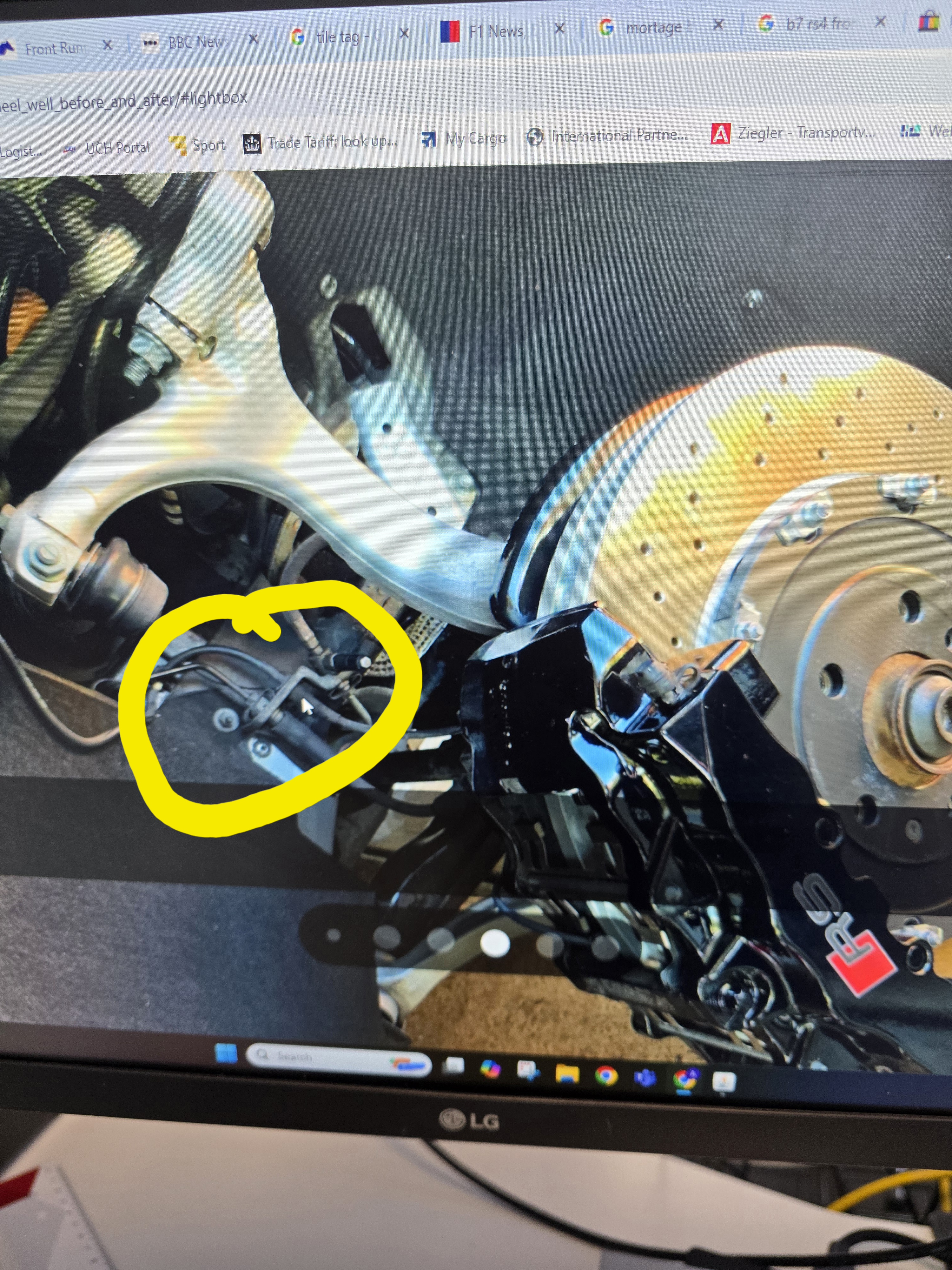

I've got a set of braided hoses to go on the car. The rears are done, but I've got an issue with the fronts. The joint/union where you'd attached the brake pipe (braided hose) to the car ( the hard line) is heavily corroded. The part i mean is circled on the attached picture. How do i get this replaced? I am being told that its an engine out job to fit new lines from the servo to the hub? Is this true?

If the problem is the steel hard pipe and the M10x1 fitting which screws into the fitting on the flexi is badly corroded then it may be possible to repair it by cutting the bad section of the steel pipe back and making a short repair section.
You need to be sure there is enough steel pipe to get a new M10x1 male pipe fitting on plus room for a pipe flaring tool to make a single flare. Flaring steel pipe on the car is difficult so if you have not done it before get some scrap 3/16 steel pipe and practice until you can form a perfect single flare.
You can buy male to male jointing pieces or use a male M10x1 fitting into a female one. Normally a short repair pipe made out of copper/nickel (Kuniform) tube with fittings needs to be made to replace the section of pipe removed. Kuniform tube is easier to flare and bend than steel. Copper tube is normally not recommended.
Do not use 3/16 compression fittings found on ebay, they may not withstand the fluid pressure under heavy braking.
If you don't have the tools or skills then a good independent garage will be able to do it provided there is enough pipe to work with.
I have just done both front sides on a Range Rover L322 with the same problem. It was awkward and time consuming because space was tight but it worked!
Good luck, Ed.
