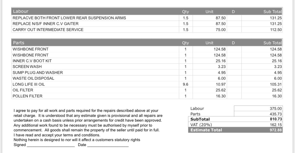

We’re not comparing apples with apples but for reference here’s a quote for work I’m having done from an Audi specialist
