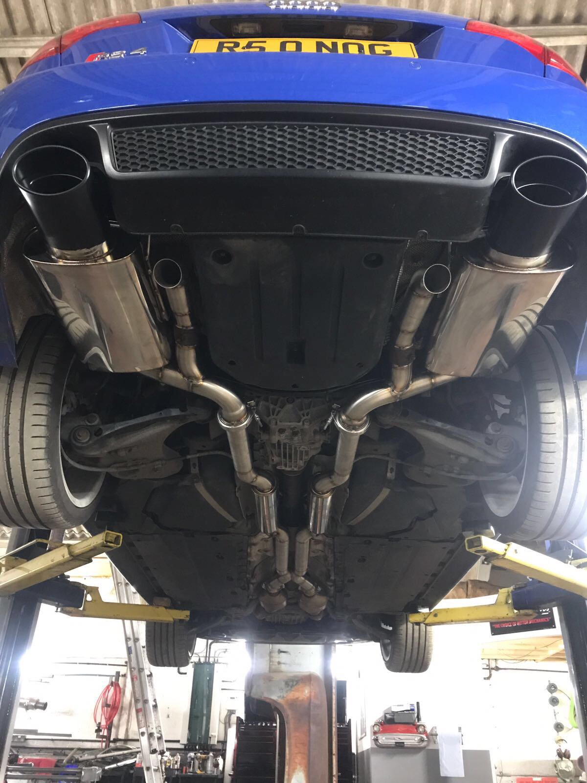

I had a custom built system by Badger Burton over Aylesbury way
It was a while back mind, but i do remember it wasn’t that much more expensive than a Milltek at the time.
Valves still worked on the s button,and a quality bit of kit

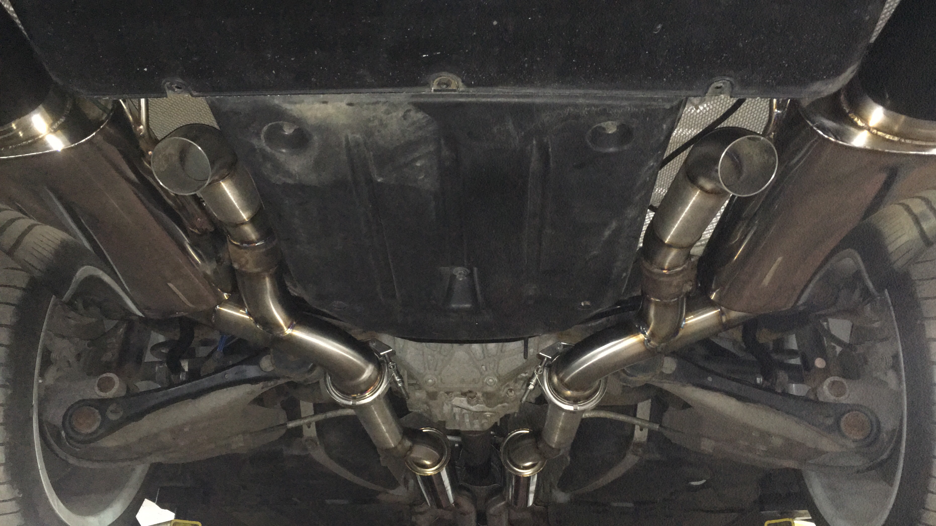

What are the two pipes pointing down out of interest?
Is that an original Nogaro?!?! Amazing if so, I thought there was only 1 or 2 made in that colour. Sorry to take the thread off topic but would love to see more pics.

It was the only Nogaro bread van there is a saloon also.
The 2 pipes in question are straight through so when when you put in sport it was loud
